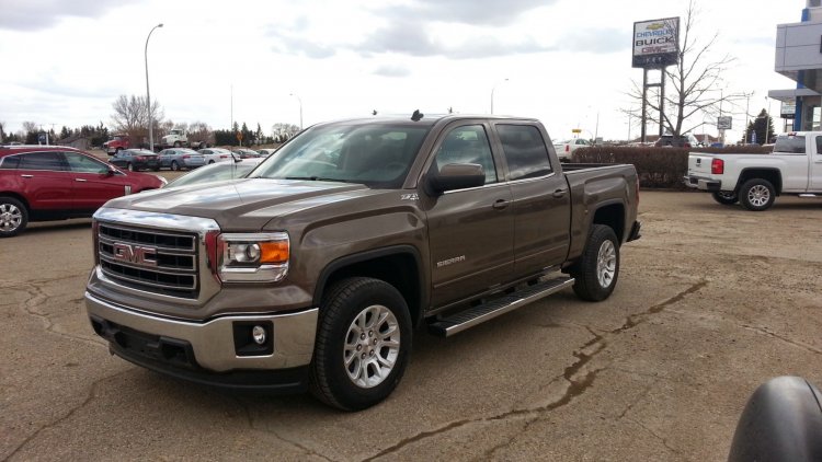

Any help would be appreciated.  I included a pic of the truck when I bought it if that helps.  The only thing I've added to it so far are some shity Putco bed rails, a decked bed system and a wheelchair lift in the bed.

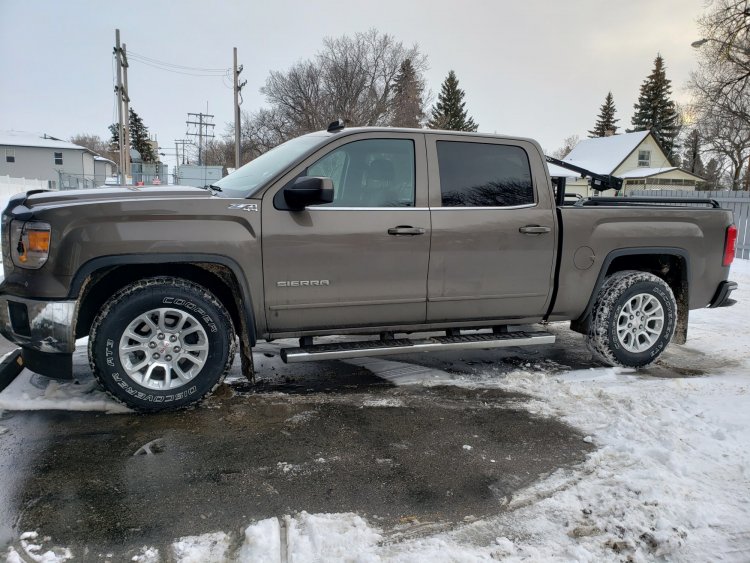

Took this of my truck yesterday if you want to see how it looks now.  No new tires yet but its got shitty Putco bed rails and a wheel chair lift.  I had a Decked drawer system in the back but I had to ditch it for the lift.
Now that I look at it I'm considering a leveling kit.......nah then if I put a load in the box or use a trailer the front will be higher than the rear.  Ew

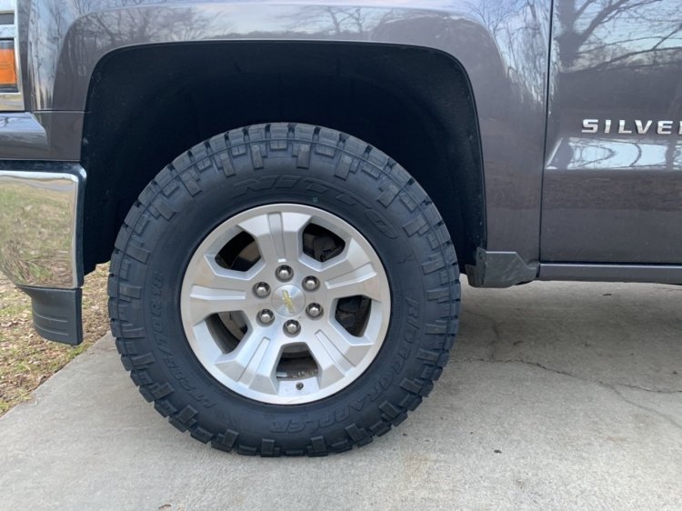

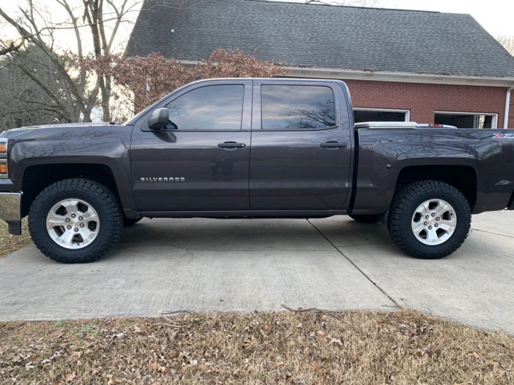

On 12/3/2019 at 6:12 PM, jcrowden said:
Put 285/70/18 on mine today with a 2” RC leveling kit.
Nice!  Just got mine done today it'll be my next post.  Also what brand of tire did you go with?
Got my Cooper Discoverer At3 4S installed today.  Finally got the price I was looking for and it was local so I didn't have to got 70km to get them installed.  Wanted to get the Toyo's but these will be fine I think.  Road noise is nothing from the Cab of my GMC, they definitely ride better than my stock Goodyears and they are awesome on snow, ice and some mud I found cause for some reason we went from -34C to -1 C in 2 or 3 days and I found a small unfrozen mud pit (unfrozen cause Its a heavily driven mud path between 2 stores).
DISCOVERER AT3 4S™ - 265/70R18    116T   Dia  32.64
Stock was Goodyear Wrangler 265/65R18 Dia 30-31?
Well if you round up I got 33s lol.  Will post another close up pick but site will only let me post 1 pick of 4mb or smaller per post?  oh well.
Ok still getting the image thing will try again tomorrow. Oh and for those wondering it was about $860 Canadian for these tires after taxes and installation fees.  About $400-500 cheaper than the Toyos I was looking at.  Anyways these look sick compared to my old tires.  Definitely fills out that wheel well more. Here's a link to the tire on Cooper's website it anyone is interested.  It's not a full fledged truck tire but it has the 4 peak snow rating which I can tell already blows my goodyears out of the water (they were still good tires with 8/32 left).  The load bearing more than meets my needs and some crazy Russian/European? tire testers (Dacia Duster Trails) help decide it for me.  link below.
