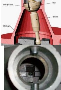

Remove the rubber boot around the bottom of the shifter, remove the shifter from the transmission. Look at the shifter handle and down into the spot were that shifter sits. Make sure its all in place and not bent. If that is strait disassembling the transmission for a closer look may need to be done.
This is a good place to start.
Should look like the pictures below.

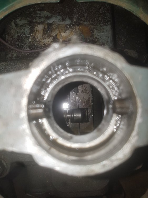

Mine looks a little different. Cast iron case with an aluminum top cover....
Also, would it be worth prying the knockout on the trans tunnel to access the top cover? I was told the trans has to be in reverse to remove the top.....?

You can remove the 4 bolts on the tower and see down inside. You might be able to see if a fork is bent. They don't bend often. Prolly wore the teeth off a gear.
Get that top off and you should be able to tell.
