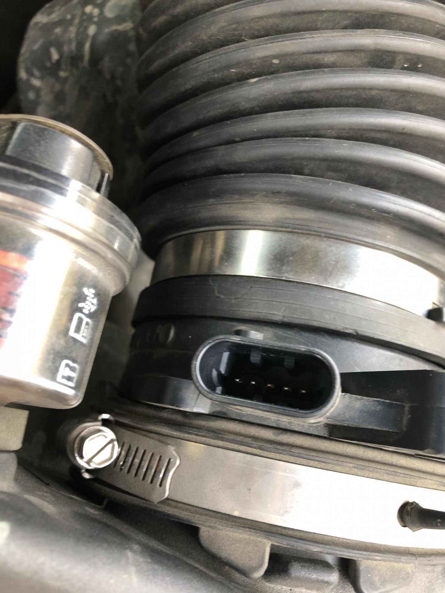

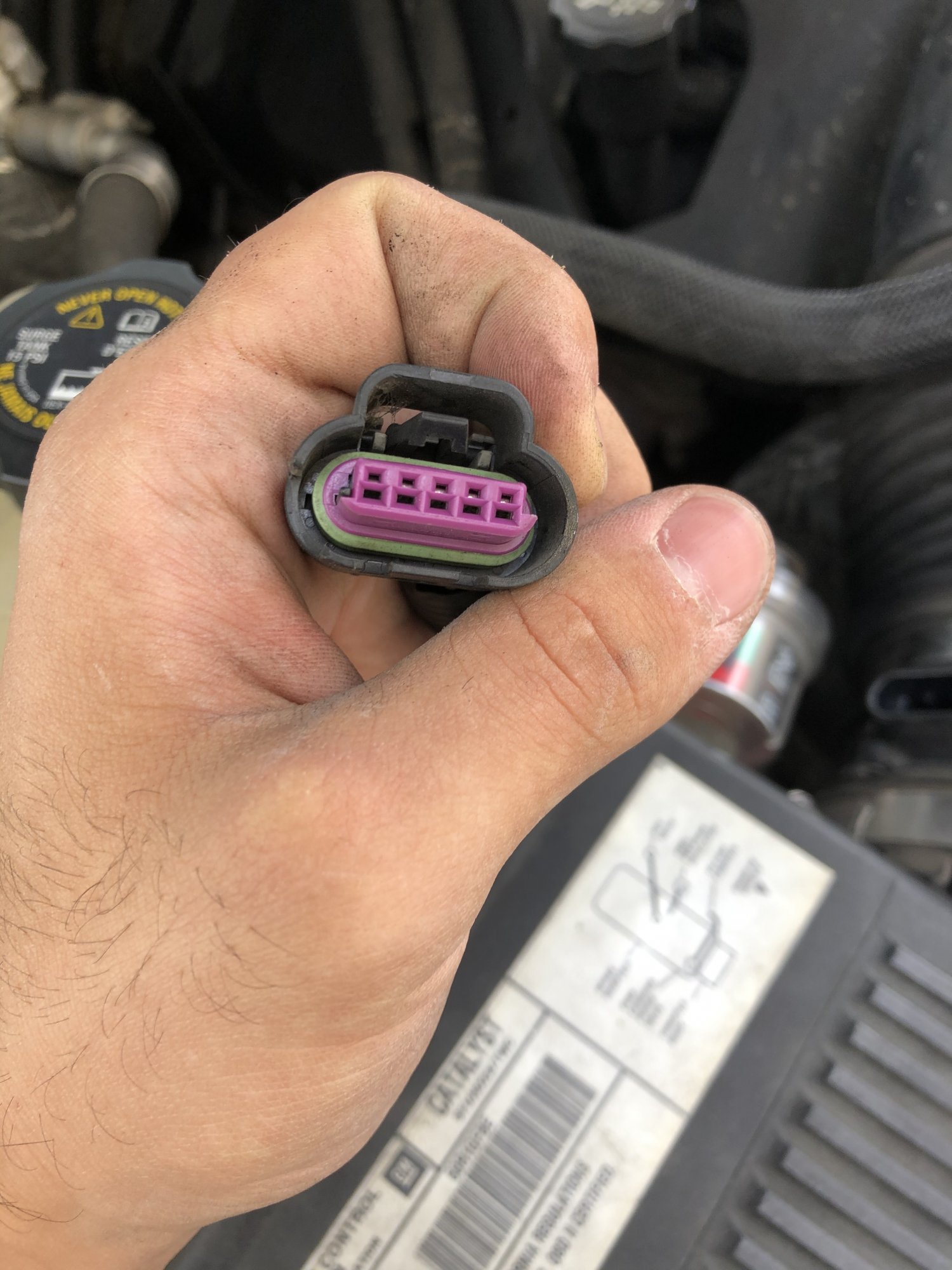

I just checked the pins and they seem fine. Any way you could link me to a YouTube video of how to check the wires? There are so many I don’t know which one to choose. Also do you think I should get some mass air flow cleaner and clean the whole maf with it? When I took it out black gunk got on my hands
Any one of these vids are great. Different vehicles, but same principles apply: https://www.youtube.com/user/ScannerDanner/search?query=MAF
Pins look good from here. What you'll be cleaning is actually on the inside. Black hands from touching the MAF itself is normal underhood grime, or old rubber coming off.
The inside of the MAF is what you need to clean, and you need to be EXTREMELY CAREFUL doing so. The little wires in there are EXTREMELY fragile, and hard to get to. You'll need a brush, preferably on a wire so that it can be bent 90° to reach the front of the wires (facing the incoming air). Also make sure that unit goes back in EXACTLY the way it came out (unless that was wrong to begin with). You can install it backwards There's usually an arrow on the rubber indicating direction of airflow.
