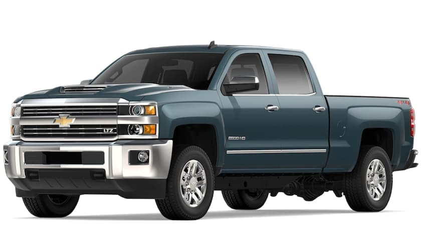

Who’s installed a light bar in the 1500 front bumper? I’ve seen a few pics of it in the 1/2ton and mostly in the hd trucks as they have a larger bumper..
looking for info on which brand to use as they all have their own Product dimensions.
Seen several, there are a few models that you can not do it with.  Believe that it can not be done with the Z71s.  The pictured LTZ can probably take 2 LED bars, in the middle of the bumper.

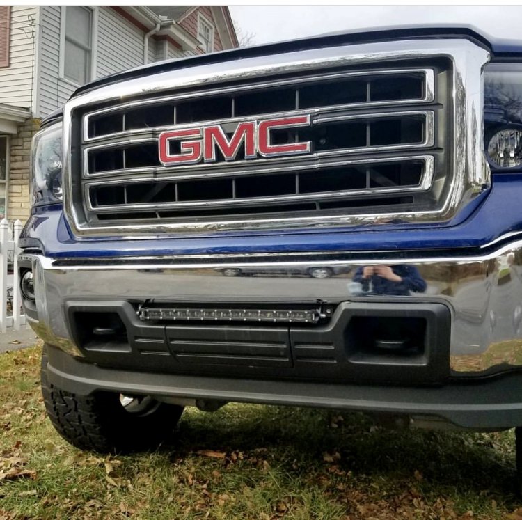

I got mine off Amazon 21 inch for my 2015 GMC Sierra.  I also got an illuminated rocker switch that I cut into the panel below the steering wheel.  It only works when the ignition is on as I wired it into the fuse panel on the driver's end of the dash.  The drawback is that the illuminated "on" switch is partially obscured by the steering column.  Also be careful where you place a switch if you use that panel as there is substantial metal backing behind it.  Very impressed with 180 degree bright light for our rural roads.

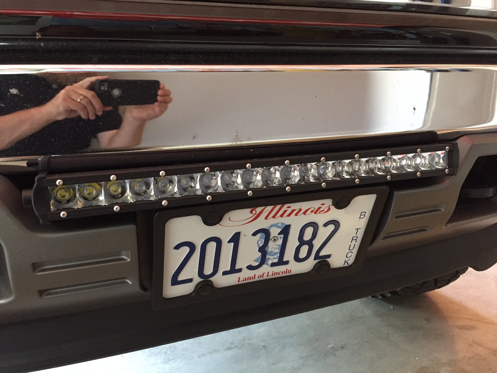

I purchased a 20" Single row LED bar from Rough Country. Fits perfectly in that space you are talking about. pic21.thumb.JPG.9bd5c8dbf43e1a8a1c94292b8f3ff7fd.JPGBshelz1.thumb.JPG.9a84bf362ff2e938d486c9cfa4b8e175.JPG

how difficult was it to mount it in there? Any chance you could share more info/tips for the next guy
On 1/22/2020 at 9:21 PM, Bill109 said:
This is Perfect. I’ll probably end up with the same one.
I'll get back to you this weekend with more pics. Out of town right now.
