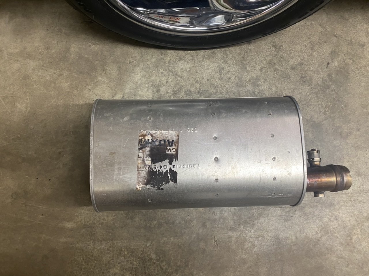

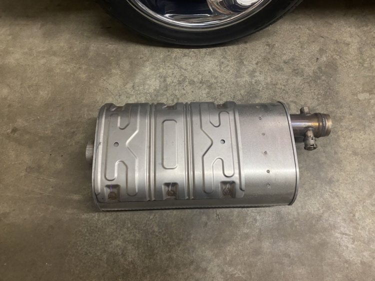

That’s how I did mine. Stainless steel 3” straight pipe deleting only the muffler and flap using stainless steel band Style clamps and hardware. Granted I do have the custom with dual exit unlike you but I love it. It’s not too loud but definitely wakes up the sound on my 19’ 5.3

Can’t seem to post a video but it sounds better than any muffler replacement video I’ve heard
