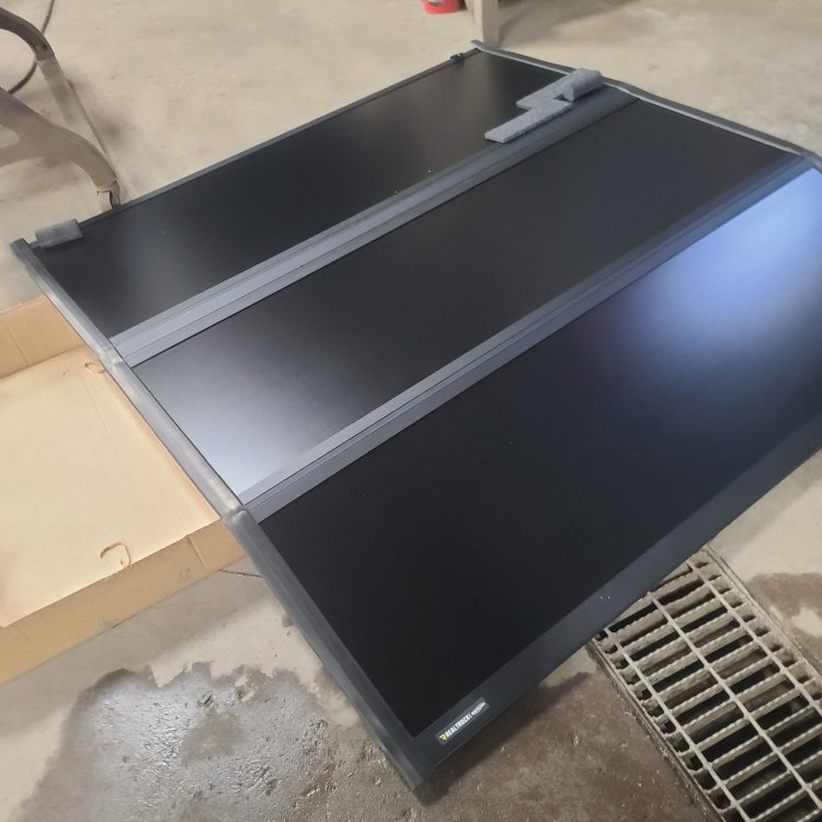

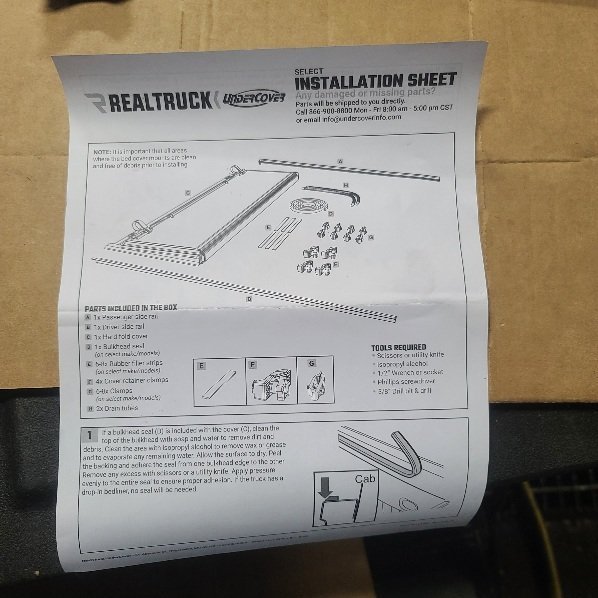

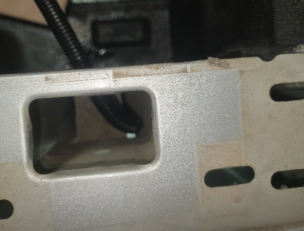

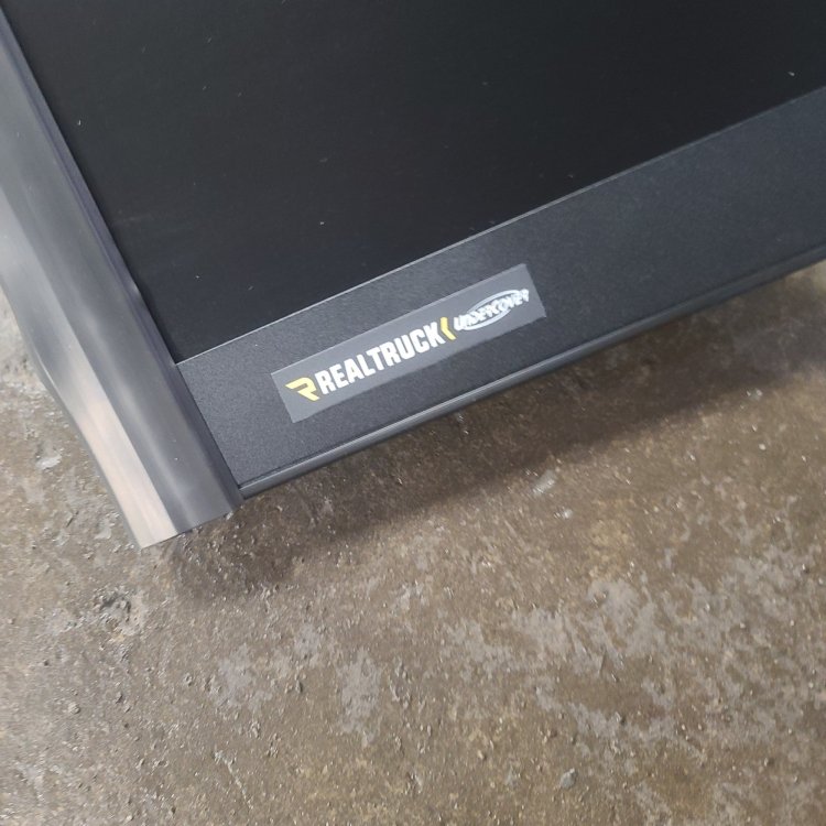

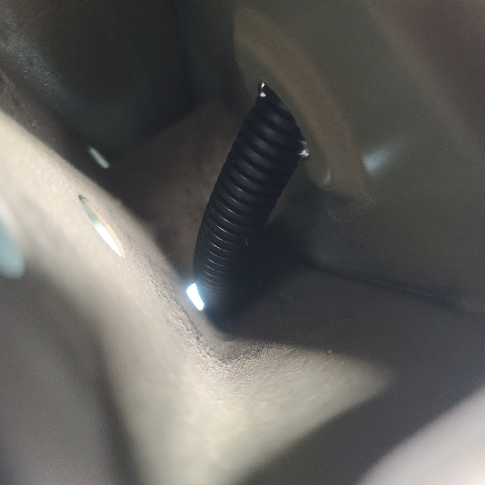

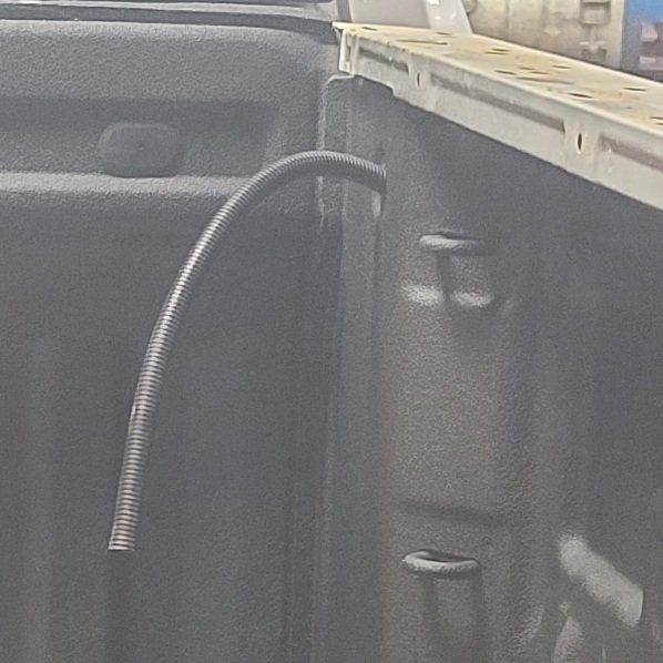

That hole is perfect for drain tubes from REALTRUCK Hard Trifold cover. No need to drill a 5/8 hole mentioned in instructions. I'll add pics later
Edited by GiddyUp Silver
Added pics
