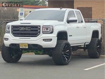

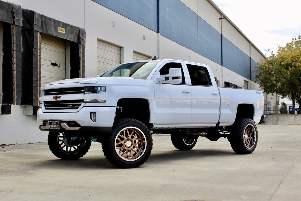

I'm scooping up a 2016 1500 CC Denali and I'm looking to work on it right away. I'm looking at the Rough County 7" suspension lift in order to fit 35s/325s, the RC traction bars to limit axle wrap, some 20" Fuel Contra or Assaults on 35s/325s, and possibly some Bora hub-centric adapters to widen the wheelbase and flex the stance a little.
I'm looking for any feedback on that potential build. What have the reviews been on that lift, how wide I can go with those adapters with that lift and wheel combo, what kind of offset will I require, etc?
I've included links to the products I'm looking at, and a pic of the overall look and stance I'd like to recreate.

I like the idea of more rubber, so 12" width sounds great, but I'm not familiar with size limitations and amount of lift required to clear things, so I defaulted to 20x10, with the bora adapters. I ran a set on my Titan yrs ago and loved them, but if I could achieve a similar stance with more wheel and rubber and forego the adapters, that would obviously be preferable. I dig the flex of the truck in the reference pic, which is primarily what I want to recreate more or less, but with less wheel face. I could see possibly going with 22x12's if they'll clear, but can't see myself going up to 24's. Aesthetics are subjective, and that much wheel face isn't really my thing.
Thanks again for the feedback. If you think I'm good to clear 22 or 20x12's on 7(ish) inches of lift, I'll definitely see what the options are down that path.

So the two things about the RC lift that are negatives is that the drop crossmembers are not true to lift size so you’re going to get more angle on your CV shafts (i’m assuming your truck is four-wheel-drive) which isn’t the end of the world but it’s putting stress that you don’t necessarily need. The other is more negative for you and what you’re trying to do is that this RC kit is a lift bracket kit not a lift knuckle kit so it keeps your track with the same as stock as to where a knuckle kit will actually push your track with out about an inch and a half. So just something to think about.

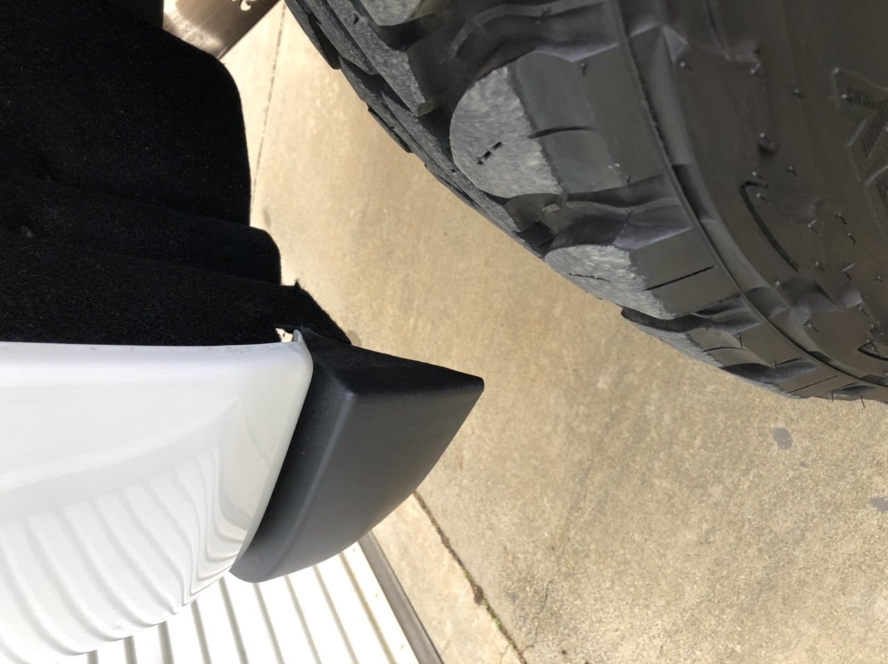

as far as the wheels go running a 22 x 10 with 2 inch wheel spacers or running a 22 x 12 is basically the same thing as far as fitment to your vehicle and turning clearances. If you like the look of what a 22 x 10 or 20 x 10 looks like on your truck then go with that but adding the wheel spacer you might as well just do a 12 wide. I’m not sure what you’re referring to as flex only because when I hear that term I think of suspension, like a lot of the guys with really big crazy four link suspension setup’s have a lot of flex with their trucks because they can pick up one side of their rear end with a forklift and it doesn’t flip their truck over. But if you’re looking for that stance or that track with there’s really no way around Some modification for clearance if you’re set on that. You will definitely be doing some light bumper trimming I don’t know if it would be as drastic as in the picture but I would imagine there would be at least some. I’m on a total of 9 1/2 inches of lift currently and I have 22x12’s with 35s on but only had to do some very light plastic trimming which I’ll show you in a picture but I guarantee you would have definitely more plastic trimmed off and possibly get into just the corner of your actual bumper with 7. Which it is also part of the reason why I recommended the adjustable 7-9 McGaughys for clearance.B5A50A28-DB6E-4AD8-AF26-697A0563DB1C.thumb.jpeg.c4641c1fface5ec058b6ee5109c27e93.jpegE2B2E017-95D3-4022-8646-3BBAC6979628.thumb.jpeg.72f27c25c05f0d7f4dffb24586a34900.jpegFCD6046A-C9A2-44B7-AEAB-B38B2BDEE8BE.thumb.jpeg.91c7dbaa39517e0f4528396c7e28c18b.jpeg
