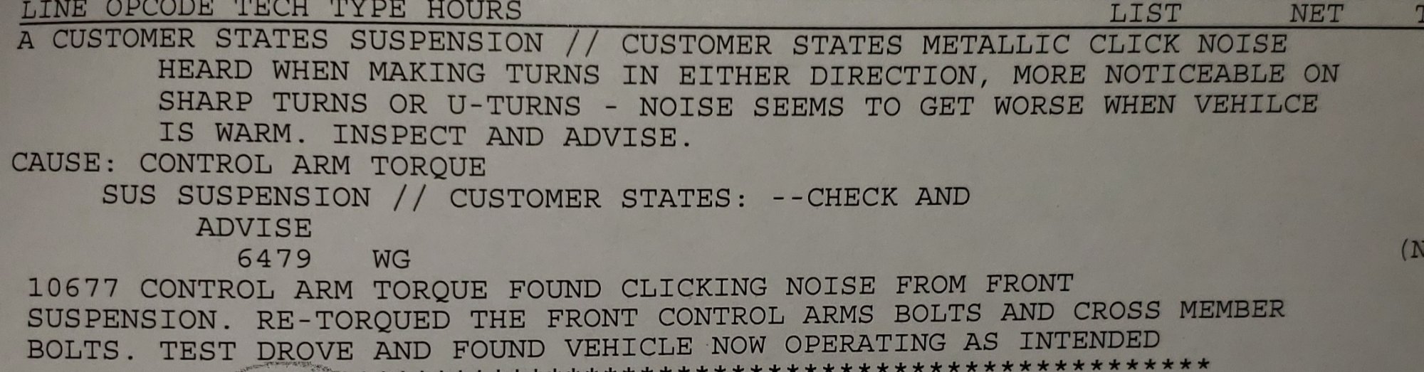

Hi guys I want to share my experience with a clicking sound when turning at low speeds. I have a 2018 Denali with 10xxx miles. I was in a parking lot and as I was turning all the way to the right I heard a metallic click sound from the driver side front end. At first I thought maybe I have something in my tires and got out to look and nothing. I ended up going home thinking it was nothing. Then as I was backing out of my drive I heard it again. I decided to take it in to the dealership and hoped for the best. I get a called saying it was ready and the problem was loose control arm bolts. They said they went ahead and re-torqued the front control arm bolts and cross member bolts. I'm happy to say that no more clicking. I'm hoping this helps out anyone having the same issue.
