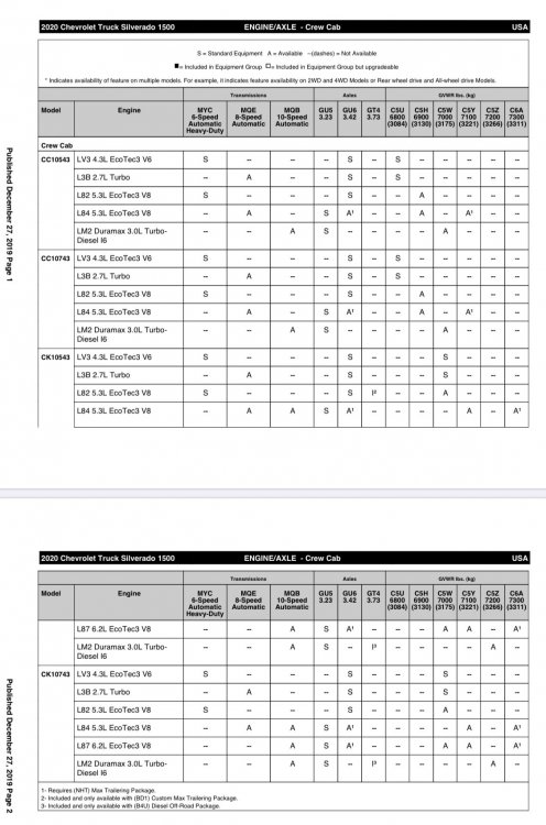

I just noticed this option on the build and price.  It requires the 3.0 TD and packages a whole bunch of stuff (Tonneau cover, chrome steps, 275/65/18 Duratracs) which besides the tires I wouldn't want.  I'm wondering if this is available another way.  Please shed some light if you have some info.  Thanks

It’s also listed as available in the order guide with the new “Custom Max Trailering Package“ on the 5.3 6 speed powertrain, but not shown on the build and price. 3.73 is not available on anything other than those two.
It's also only available on LT and RST trims (which are non-lifted).
Trailer tow rating and GVWR don't seem to be listed either.
The package doesn't currently show as available on Sierra.
B4U         Diesel Off-Road Package, includes (GT4) 3.73 axle ratio, (R3O) LT275/65R18C MT Goodyear Wrangler DuraTrac blackwall tires and (VOZ) Tri-fold hard tonneau cover, LPO
On LT - Requires 4WD model, (LM2) Duramax 3.0L Turbo-Diesel I6 engine and (Z71) Z71 Off-Road Package. Crew Cab models include (BVT) Chrome assist steps. Not available with (PCQ) LT Value Package, (NHT) Max Trailering Package, (VYU) Snow Plow Prep Package, (PDZ) Z71 Off-Road and Protection Package, (RD4) 20" aluminum wheels with Argent metallic pockets, (QAB) or (QAE) tires, (PDW) Assist Step and Tonneau Value Package, LPO, (PDE) Wheel to Wheel Assist Step and Tonneau Value Package, LPO or any other assist step or tonneau cover.
On RST - Requires 4WD model, (LM2) Duramax 3.0L Turbo-Diesel I6 engine and (Z71) Z71 Off-Road Package. Crew Cab models include (BVT) Chrome assist steps. Not available with (PCR) RST Value Package, (STH) Rally Edition, (NHT) Max Trailering Package, (PDZ) Z71 Off-Road and Protection Package, (RD4) 20" aluminum wheels with Argent metallic pockets, (QAB) or (QAE) tires, (PDW) Assist Step and Tonneau Value Package, LPO, (PDE) Wheel to Wheel Assist Step and Tonneau Value Package, LPO or any other assist step or tonneau cover.
