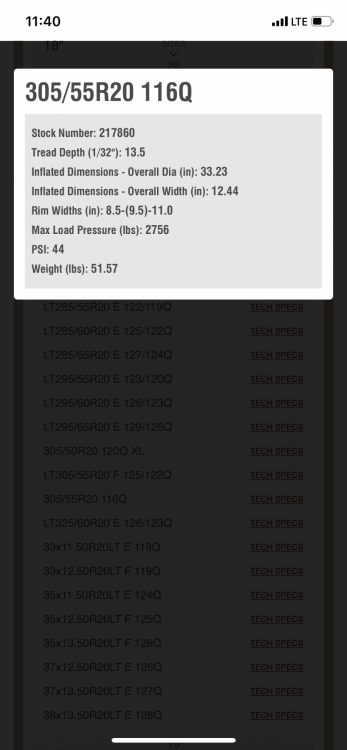

If you don't mind switching to a 305/55/20 which is almost the same size as the 33x12.50x20.
Nitto makes the Ridge Grappler in two ratings of that size. An F rated and the other is a 6 ply. I'm running
the 6 ply at 40 psi and it is 10 Lbs. lighter then the F rated.

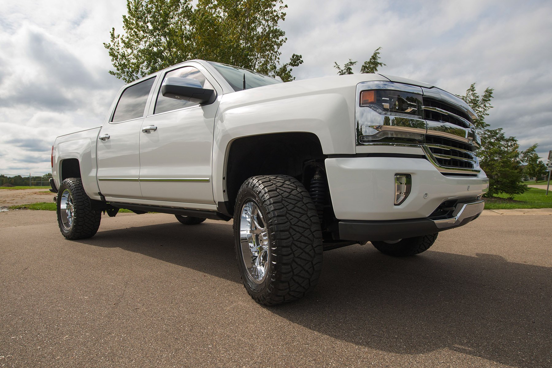

That’s great to know. I Saw that one on their site and was curious because there was no ply rating. Assuming the attached is what you are talking about? How do they ride? Any pictures? I’d love to see that size as it sits on a truck.

They ride real nice and are actually pretty quiet for an aggressive looking tire. I lost about three mpg over the stock 275/55/20's original tires. I'm sure part of that was due to the 4 1/2" lift and the wider wheels also.

Thanks, that looks killer! I've got a 2.5" level and OEM GMC snowflakes on mine. My 33x12.50 rubbed a little when they were new. Wondering if I can fit these 305s without any rubbing. Wonder if the .06" loss in width will roughly negate the .23" in height as far as rubbing goes....
Hard to say. I have them mounted now on my stock LTZ wheels for the winter. I get a rub on my sway bar at full lock due to the positive offset .c837fcc910f3ea3662da247a8b98720b.jpg
