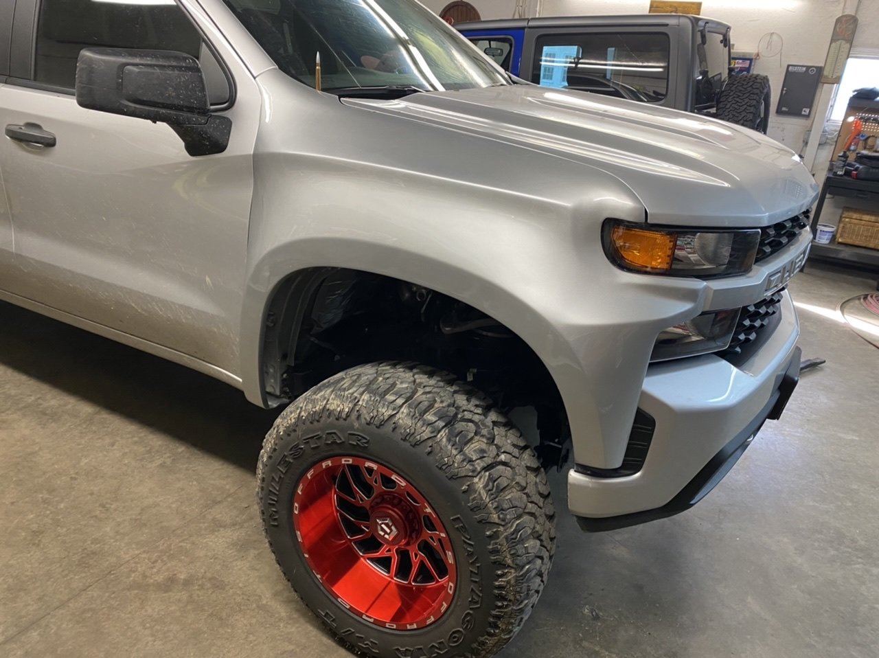

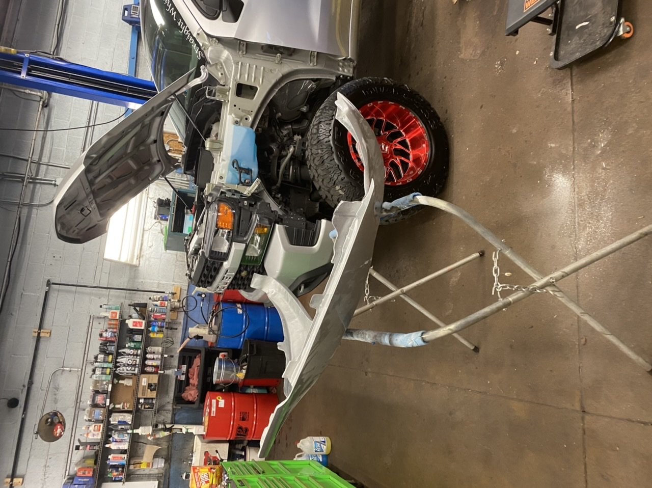

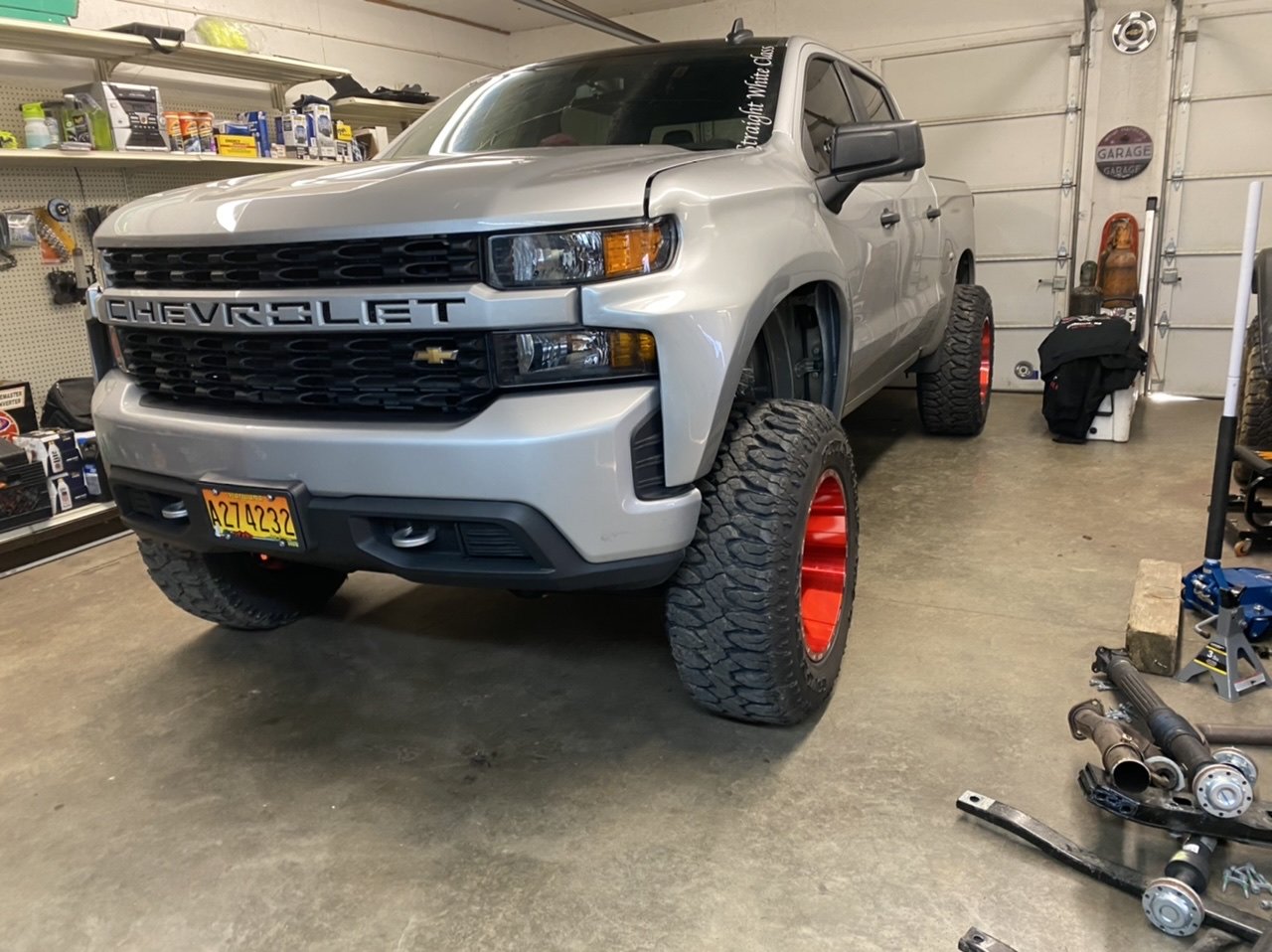

So I’m a busy man and these are a hooker to get on let alone on properly. So I’m still rocking the no fender set up and trying to get them properly set up
  • 4 weeks later...

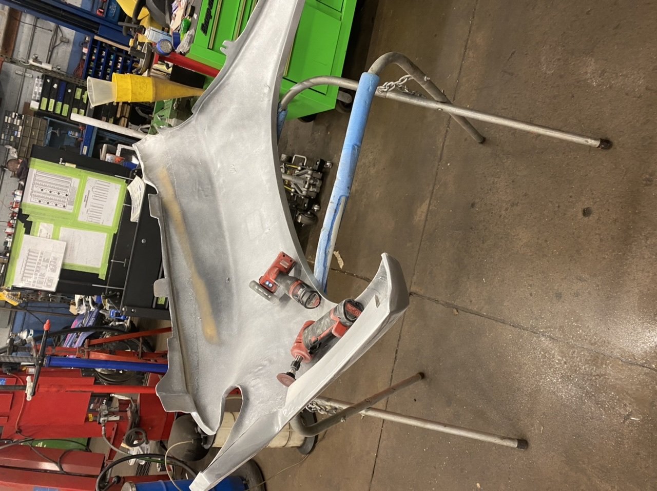

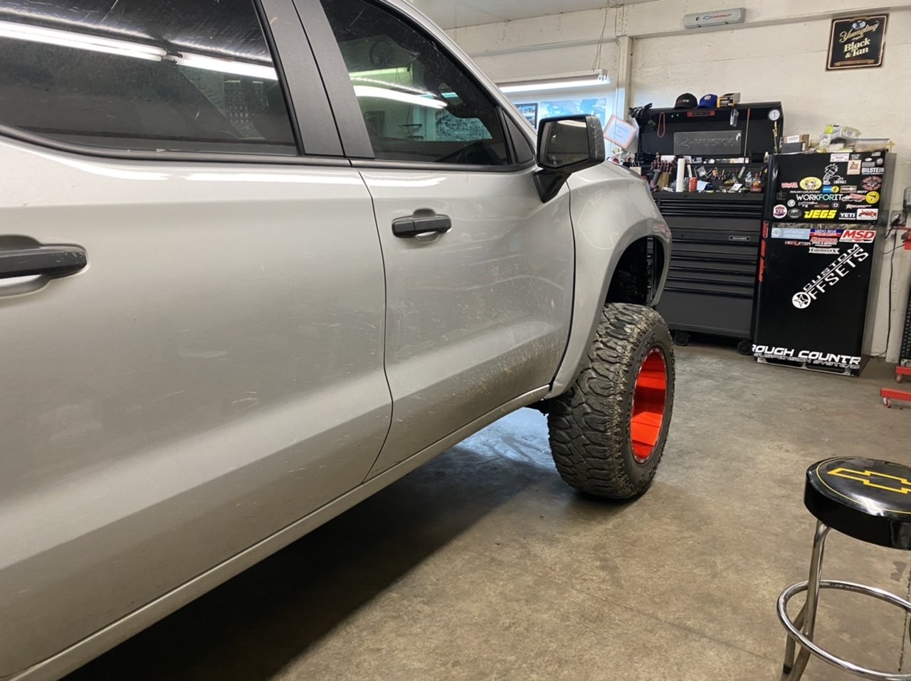

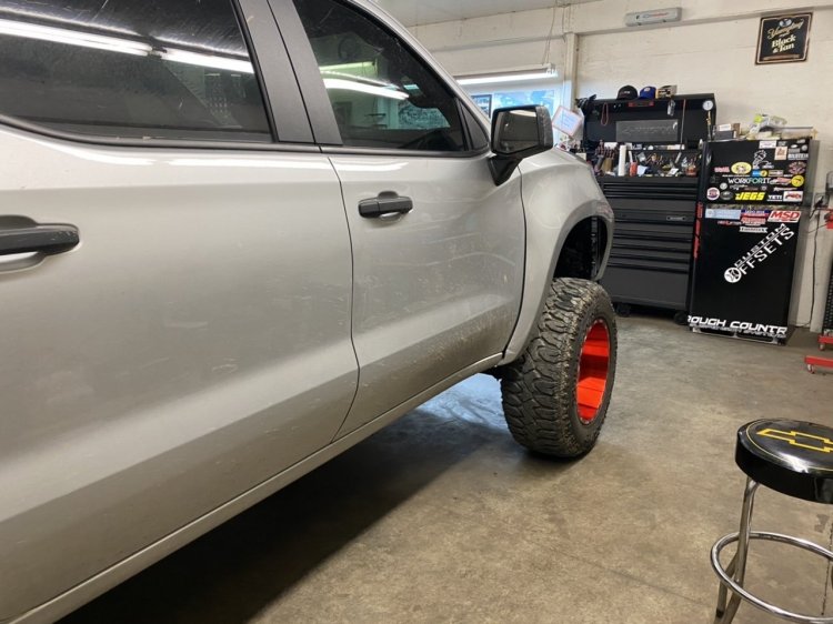

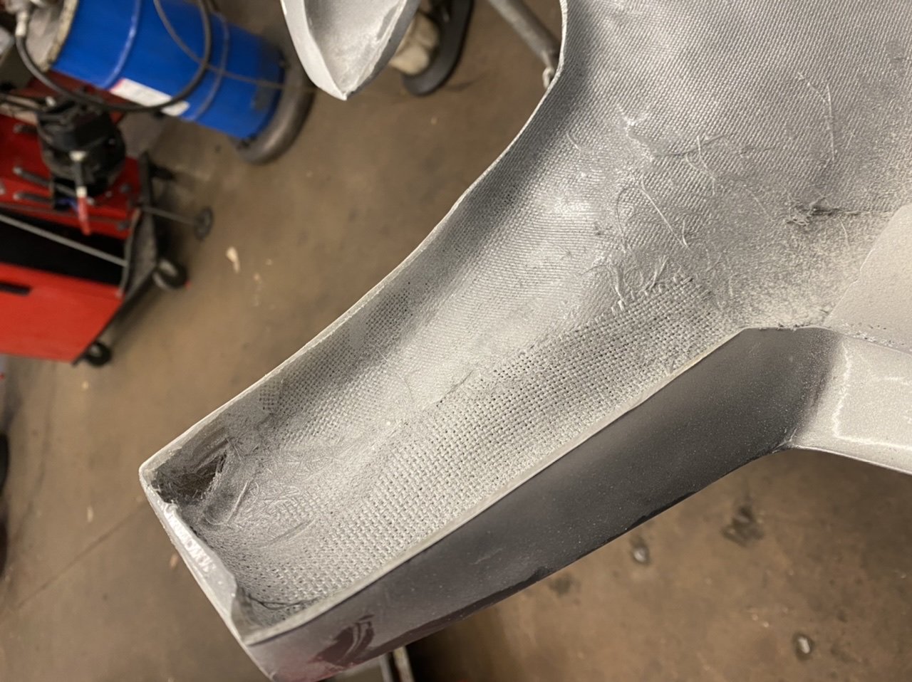

So fit and finish isn’t great to say the least on these. With everything going on with corona ive had some down time and been properly fitting them at work. Hopefully get them right this weekend and the truck to final paint this coming week
  • 4 weeks later...

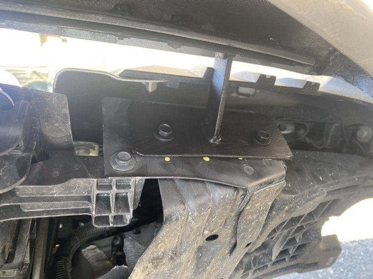

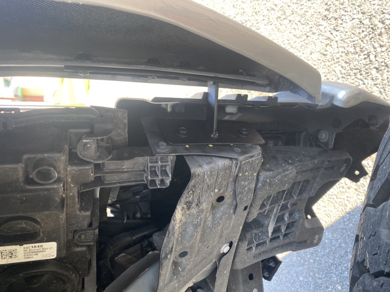

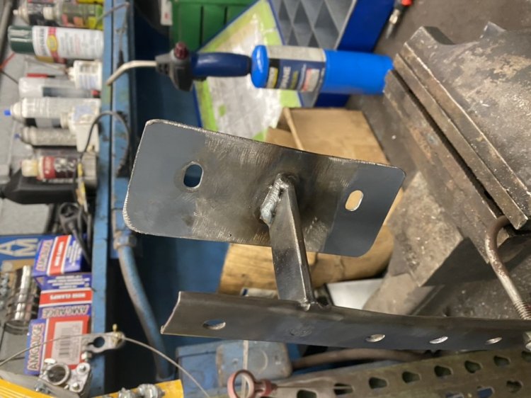

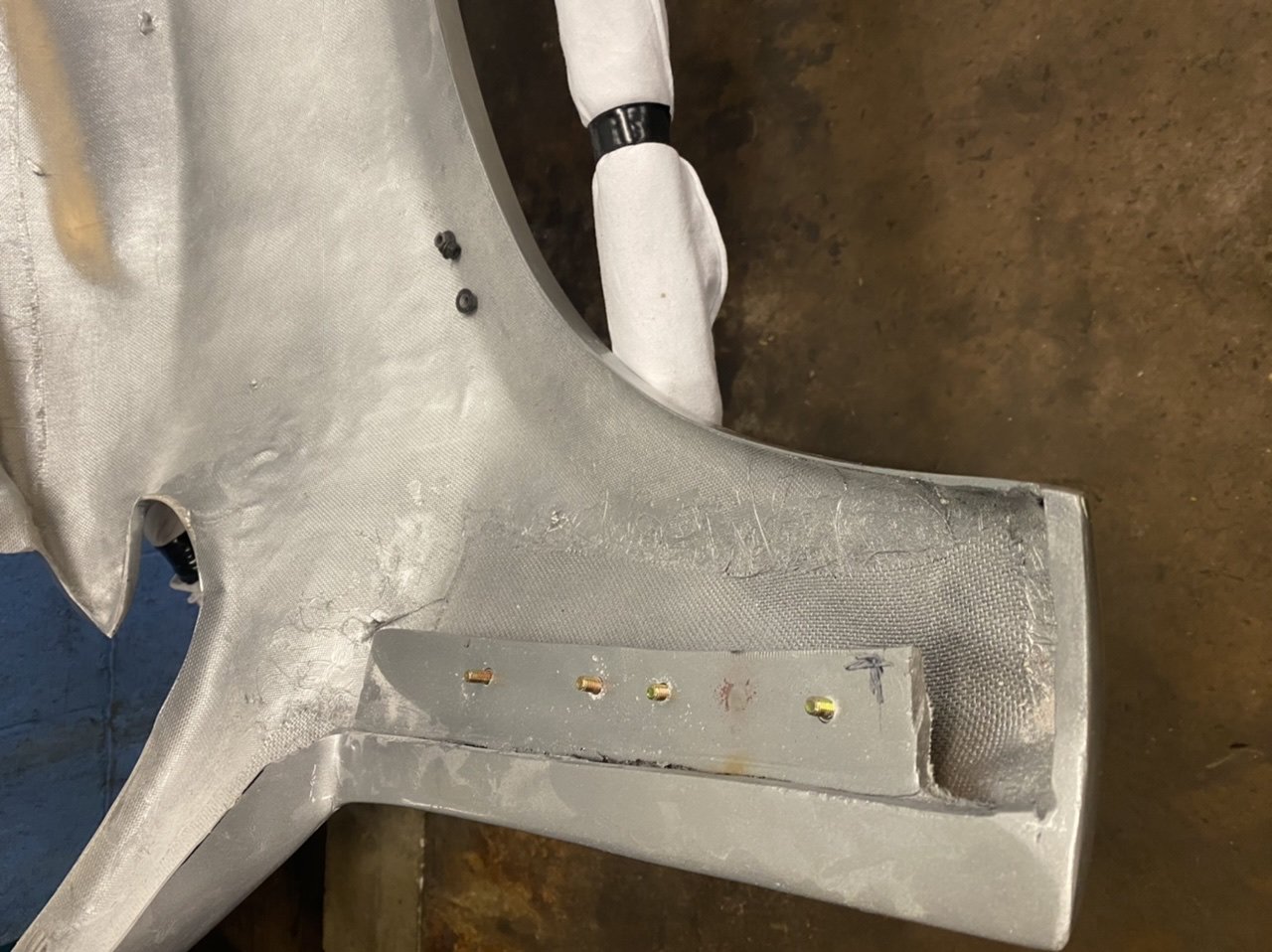

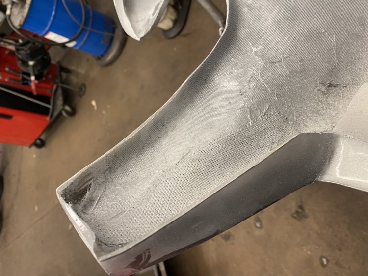

One of the biggest issues was that I had to fab up new mounts to hold the front of the fenders. With the new one piece fender the manufacturer had nothing info wise as to how to mount them. I get they are made to run through the desert but I can’t have them flopping in the breeze so we made these brackets up at work. Super solid and should do the trick.

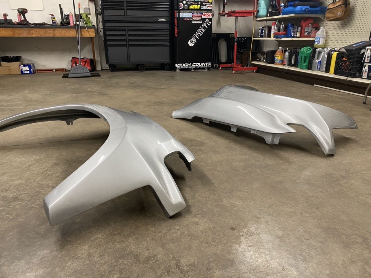

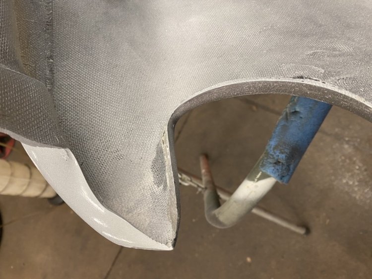

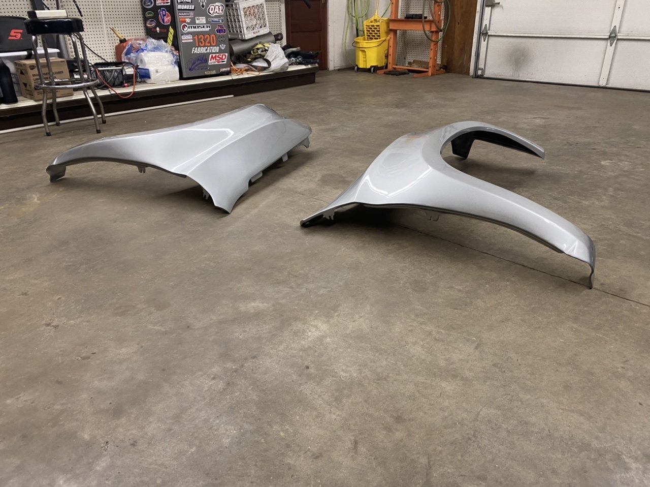

Off to paint this coming week for final blend with the rest of the truck. The paint didn’t even look close to me so we’ll see how it comes out with the final setup
