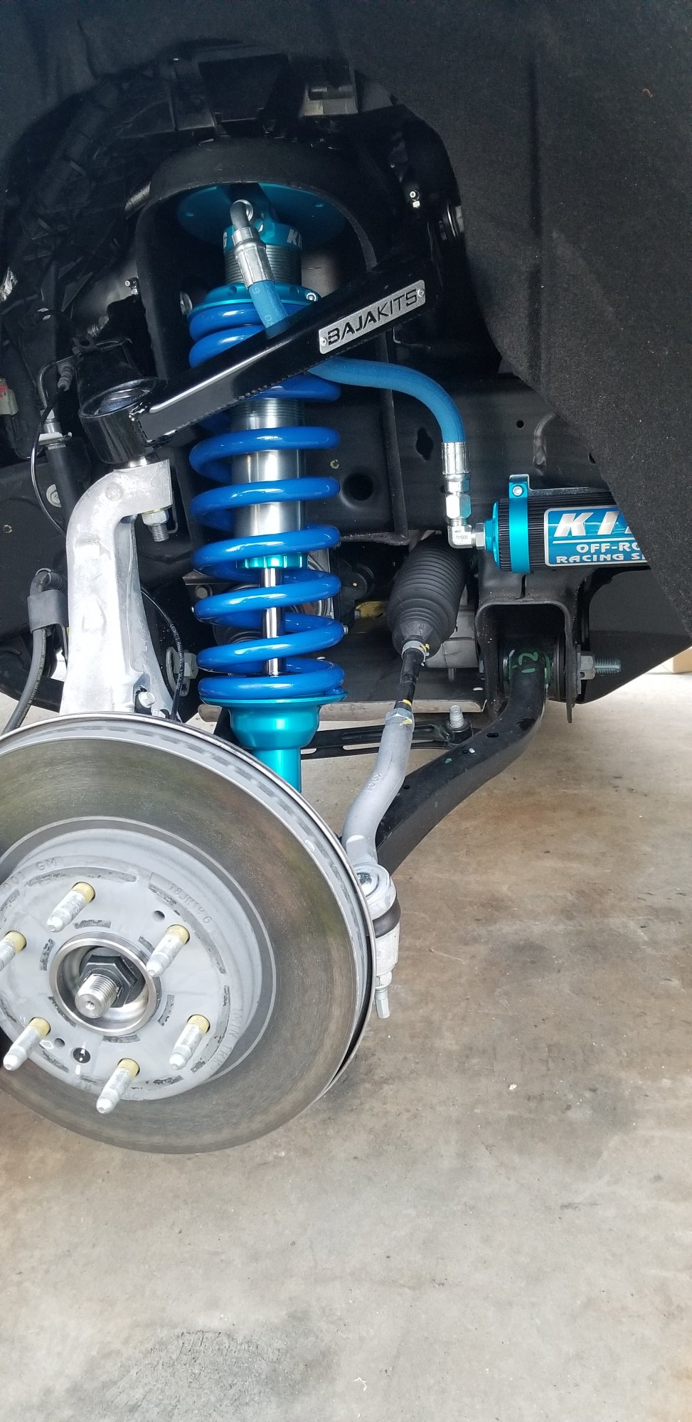

Not sure what you want to spend or the type of use you’ll be needing? I recently swapped out UCA’s/shocks all around, the trucks ride and handling have grown exponentially. It’s a totally different truck

What wheels are those if you dont mind me asking?
Outstanding! Roughly what would something like that run?
Looks like $3k - $4k.
Yes the 4K mark will get you there, you could get away with a a cheaper UCA and save a few dollars. The cognito UCA is great and should be available soon. Get the shocks direct from icon and they will install pretty easy. Took about three hours start to finish
