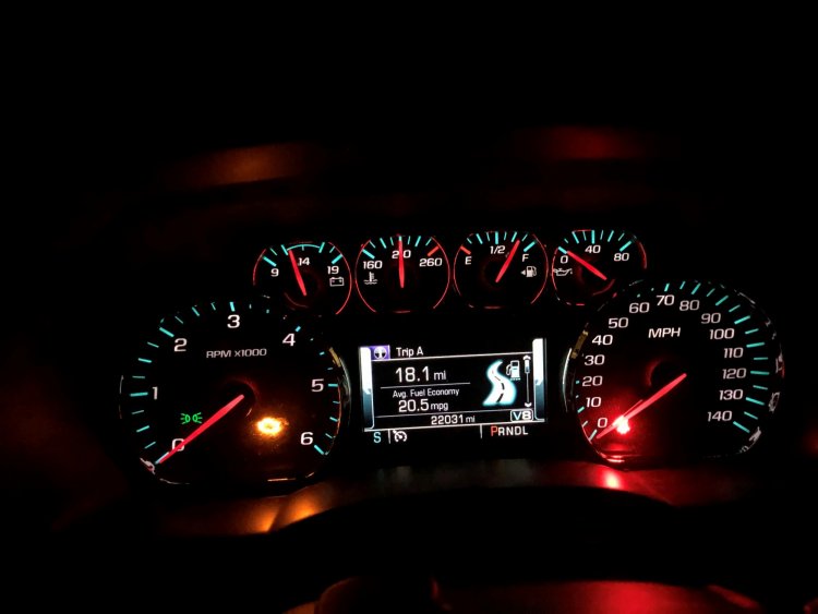

SO, last Thursday (1/23/20) night, on my way home from work, I fueled up my truck.  About a mile away from the gas station, when I noticed that the fuel gauge is sitting at 7/8 of a tank.  WTH?  I chalked it up to the pumps being screwy.
Last night (more like EARLY this morning), on my way home from work, I fueled up my truck.  When it stopped, I powered up the fuel gauge, 3/4 tank, so I squeezed the handle one more time.  It stopped after putting about $0.70 in, gauge was still at 3/4.  WTH?!!!  Went "fill to spill" with it (waited about 30 seconds or so, would flow fine for about $0.70)......(see picture, was taken in my driveway).
Ignore the CEL and seatbelt light.  Notice RPM is at 0 (ZERO).  I had shut off the engine and turned the key enough to power up the gauges.
I find it hard to believe that 18.1 miles after "fill to spill," that it's already down to 3/4.
Topped off tonight, 121 miles, filled just over 5 gallons, and here’s where my gauge went to.......
