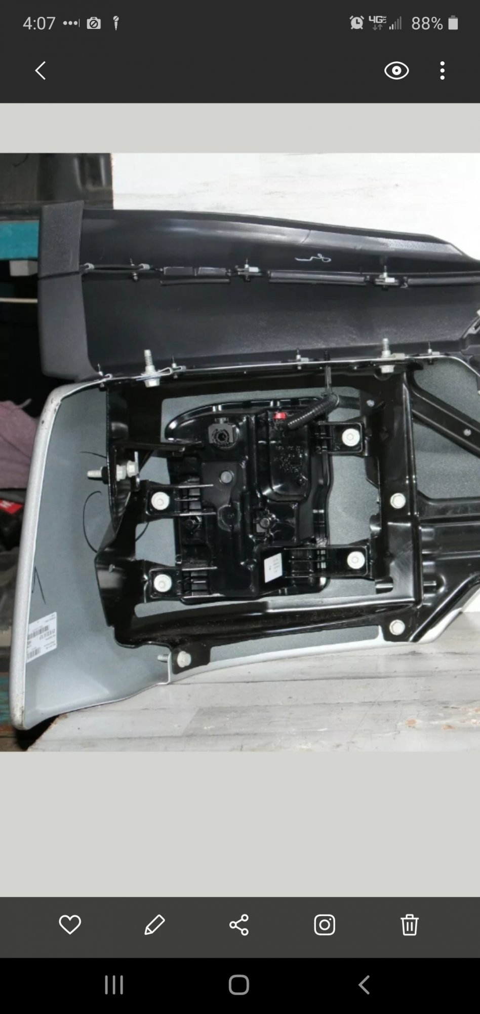

I'm not sure this is right, but I found these brackets from searching online and they look to be what attach the fog lights to the bumper.
https://www.discountbodyparts.com/catalog/feeds/Chevrolet/Silverado_1500/Replacement/Bumper_Bracket/2017/LTZ/SET-REPC013183.html?dbpcid=gglpla&utm_source=google&utm_medium=pla&utm_campaign=1597045197&gclsrc=aw.ds&&gclid=Cj0KCQiAm4TyBRDgARIsAOU75spNvS-Mh3Y_Vi-seWmbO4uiIQ50qYEfHN1f6R1AY5nTo6TTjre_24IaAp59EALw_wcB
Can someone confirm these are the brackets that attach the fog lights to the bumper and if there's other hardware needed? I've read a bunch of similar threads on the site and all I've seen mentioned are Rigid Industries brackets and all I see on their site is for the 14-15 models. I guess what I'm asking is will I be able to use mostly my existing bumper hardware to mount the bumper and just need the brackets (if those are correct) for the fog lights?
The picture I posted is the back of a bumper with fog lights and what looks like that bracket in the link that holds the fog lights on.

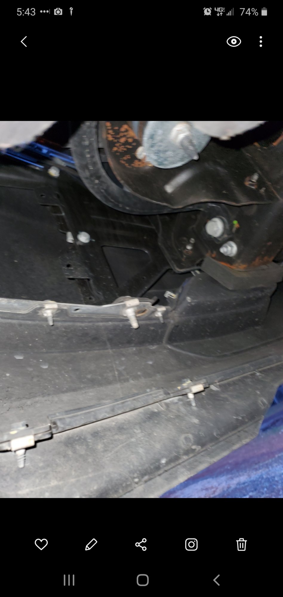

i looked under my truck at the bumper, and those brackets appear to be there.  looks like just the fog and 4 bolts are needed.  check yours out.  what part numbers did you come up with?
Mine doesn't appear to have them. If I'm looking at it right it's missing that square bracket that the fog light housing goes in with the four bolts.
According to that link in my first post the part numbers should be 84029810 and 84029811.
