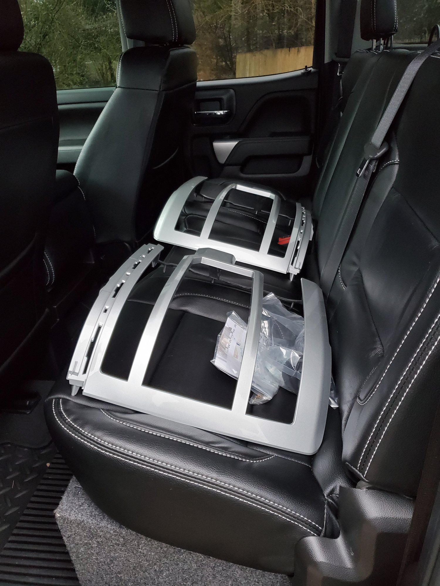

Update:
I got everything in except the bumpers and that's getting delivered to the paint shop Monday. The fog lights I got weren't OEM and have different plugs than the Gen5DIY harness. I emailed them, which by the way they are fast to respond and super helpful, they said I can splice the plugs together and make sure the connection is sealed and it'll be good.
Second thing the brackets did not come with any hardware. I guess I'm going to check with the dealership next week and if the stuff isn't too expensive I'll just get it there. I'd assume it's just simple nuts and bolts. I'm gonna get under my buddy's Z71 in the morning and look again at that.
The paint shop said if he gets the bumpers Monday he'll have everything painted by Wednesday or Thursday. So shooting for next weekend to try to get everything installed.

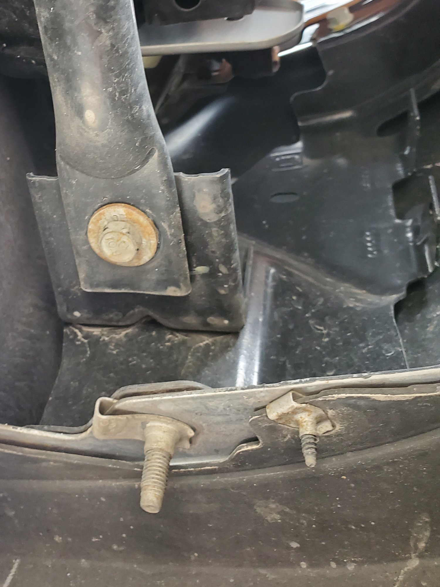

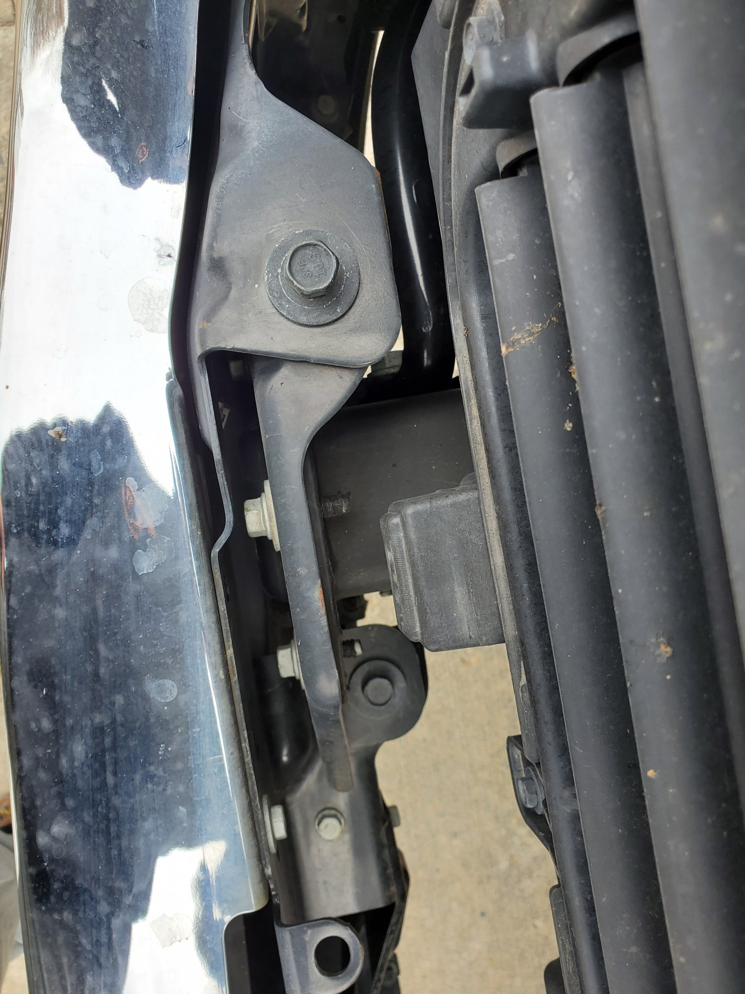

Okay, so you have to pop that plastic shroud off first under the hood and then remove the grille. It's pretty straightforward. The plastic piece is I think twelve of those plastic trim things that pop off. Then you need a 10mm socket to remove the grille. Once that's out you can see these four bolts here. Two on each side. They're 18mm. There's also two underneath that are 15mm post a pick. Once those are out the bumper comes right off.
This is the 15mm underneath. It's just those six total and the bumper comes off. The four 18mm in the first pic, two on each side, and then the one 15mm in this pic on each side.
