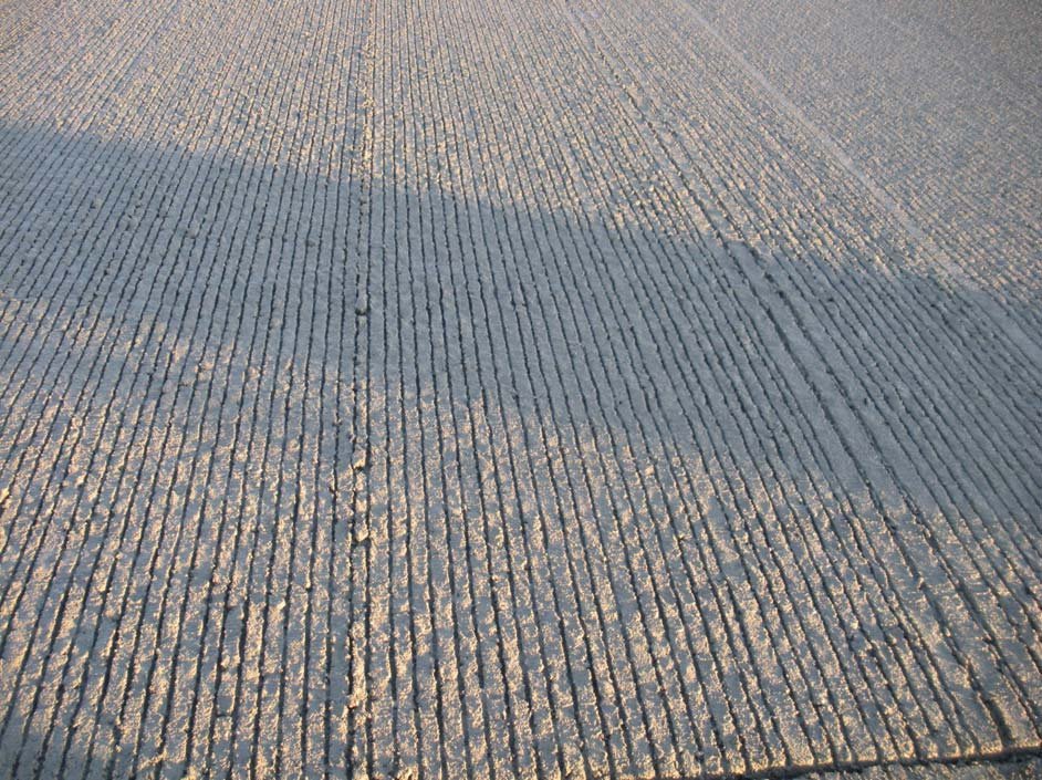

Fish-tailing on grooved cement
Has anyone experienced fishtailing on grooved cement like this? It feels like driving on Bias ply tires.
it happens at speeds as low as 40 and as high as 80.

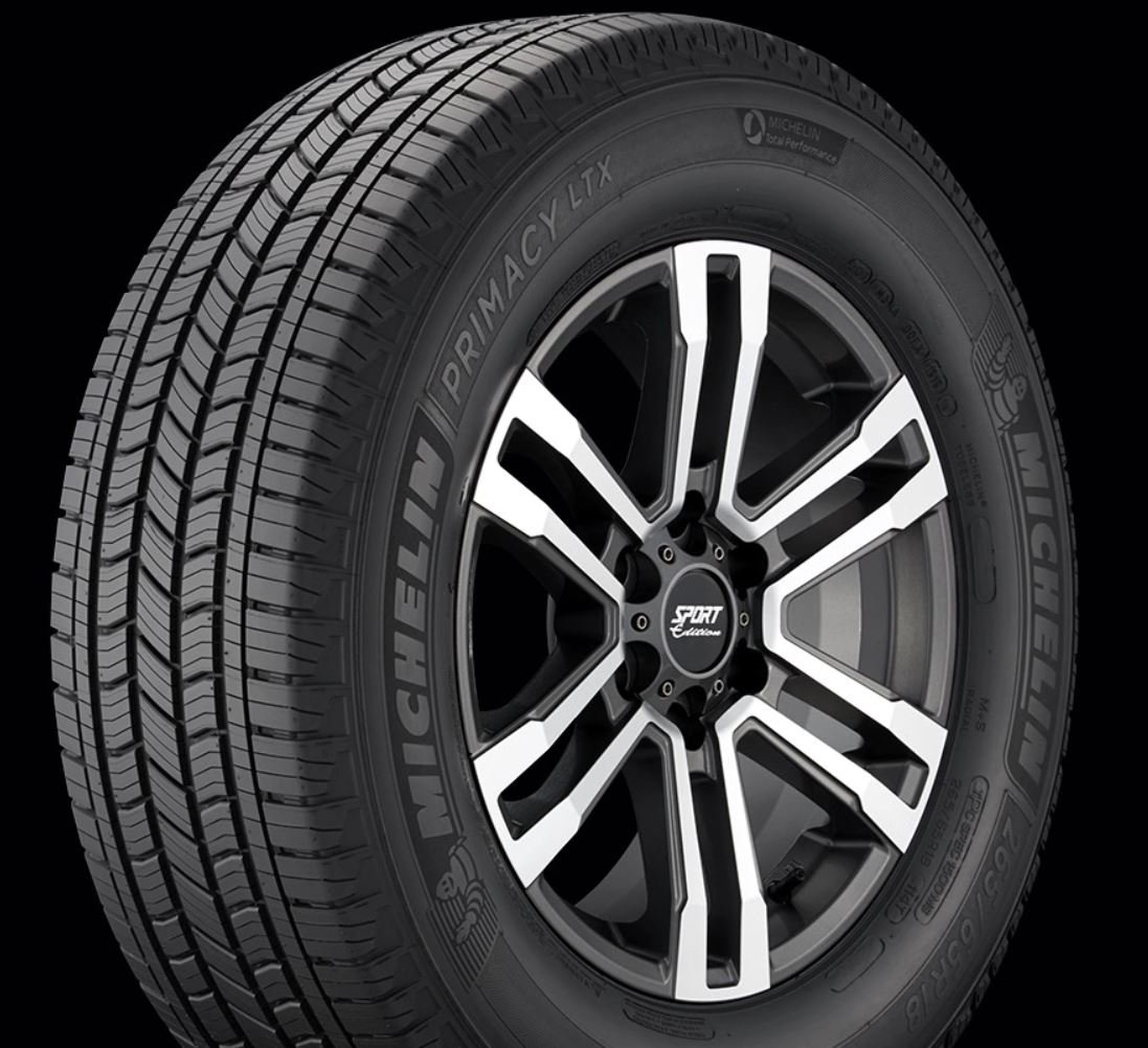

Tires are currently Michelin Primacy LTX 265/65R18

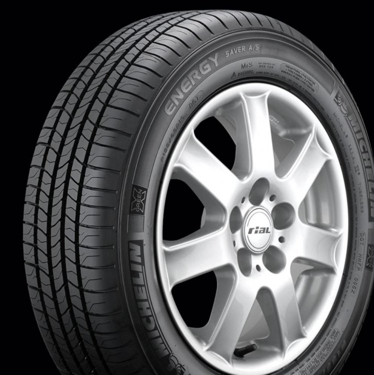

Dealer talked to Michelin and they are willing to change them out to Energy saver A/S. I havent decided yet/

That's not fishtailing, that is tramlining. It is a unique combination to the road, tires and vehicle. Wider tires tend to do it worse or very skinny tires (ie Motorcycle tires). Nothing to be worried about, if they will swap go ahead and try a new set but I bet it won't correct it, just a unique charateristic of that particular stretch of road.
