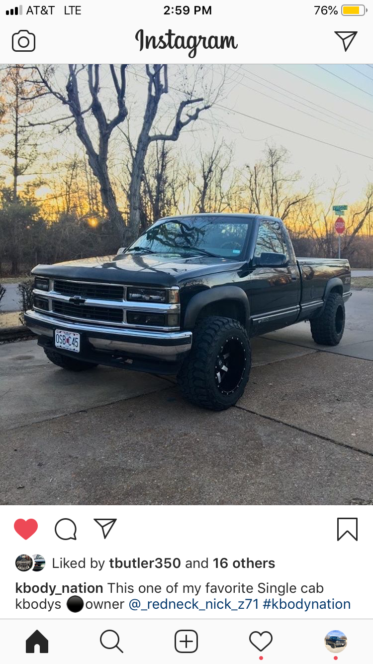

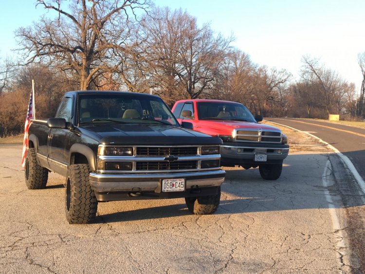

P.S here she is, pretty good for only being 15 I’d say
