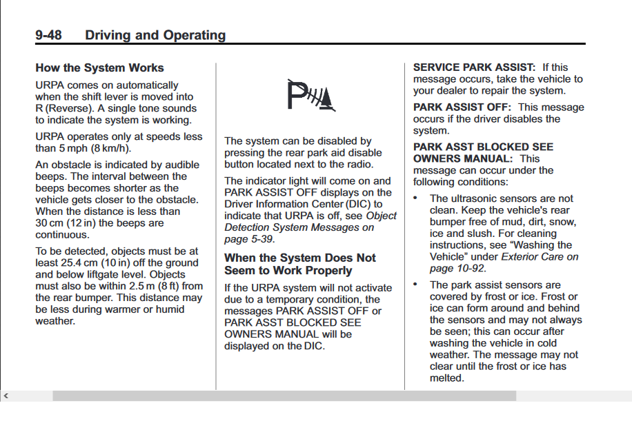

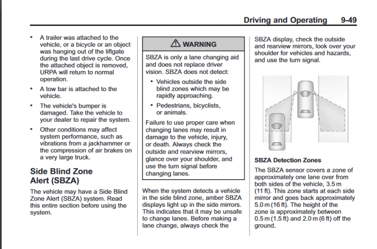

My dash panel says park assistant is blocked see owners manual and I don’t have a owners manual, and where can I get a owners manual?
https://my.gm.com/content/dam/gmownercenter/gmna/dynamic/manuals/2011/gmc/yukon/2011_gmc_yukon_denali_owners.pdf
Usually, it's as simple as the sensors being dirty (the sensors are the round things on the rear bumper--think there's 4 of them).  Soometimes, if you leave a towing hitch in the receiver, it will cause the warning message to appear also.
