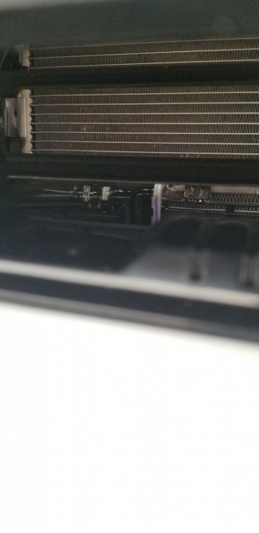

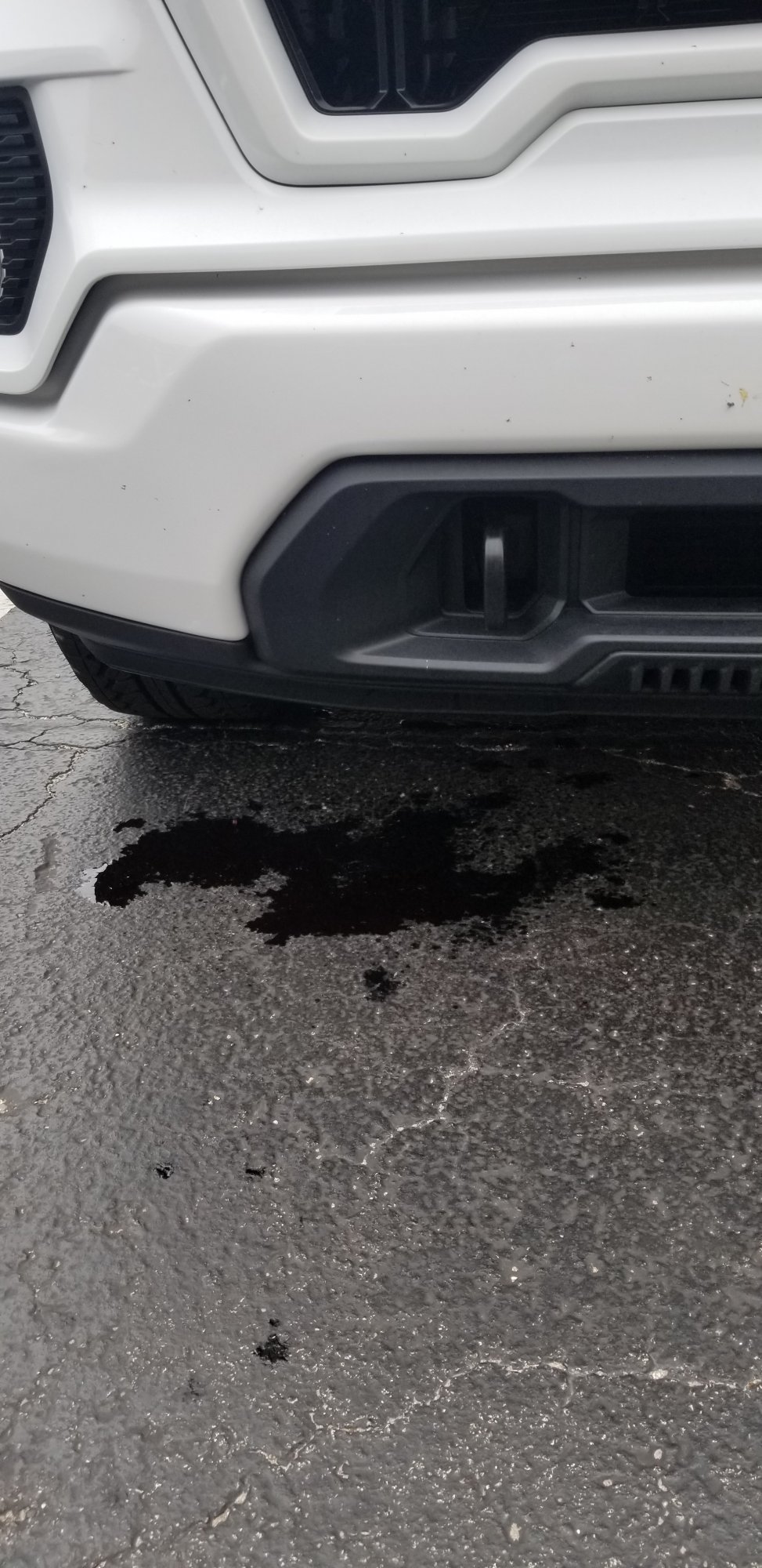

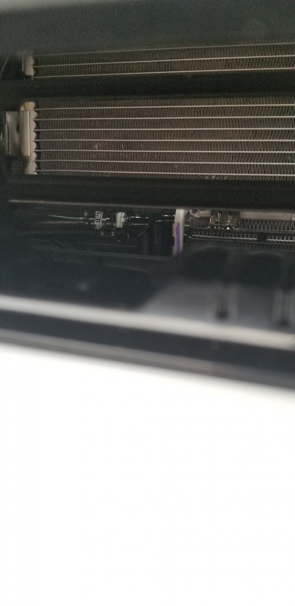

2020 Sierra Transmission cooler leak.
So I was merging on the highway the morning when I got a strong odor of transmission fluid in the cab.  Within 2 minutes the transmission started to slip pretty extensively above 1/4 throttle so I limped it to the next exit only to find that theres a fairly massive leak where the trans line connects to the cooler.   Currently waiting on a tow truck but has anyone else had any issues like this or is my bad luck streak as strong as ever?  Truck is about 3 weeks old and has a little over 2k miles of grandpa driving for the most part.

So to update my original post, it turns out the line that was leaking on the cooler had just popped off and it lost about 8 quarts.  They reattatched the line, cleaned it up and topped off the fluid and it seems to be running well with the exception of this clunk downshift I now get at 57 mph.  That's about the speed I was driving it at the time of the incident so I'm wondering if that particular gear was damaged.
