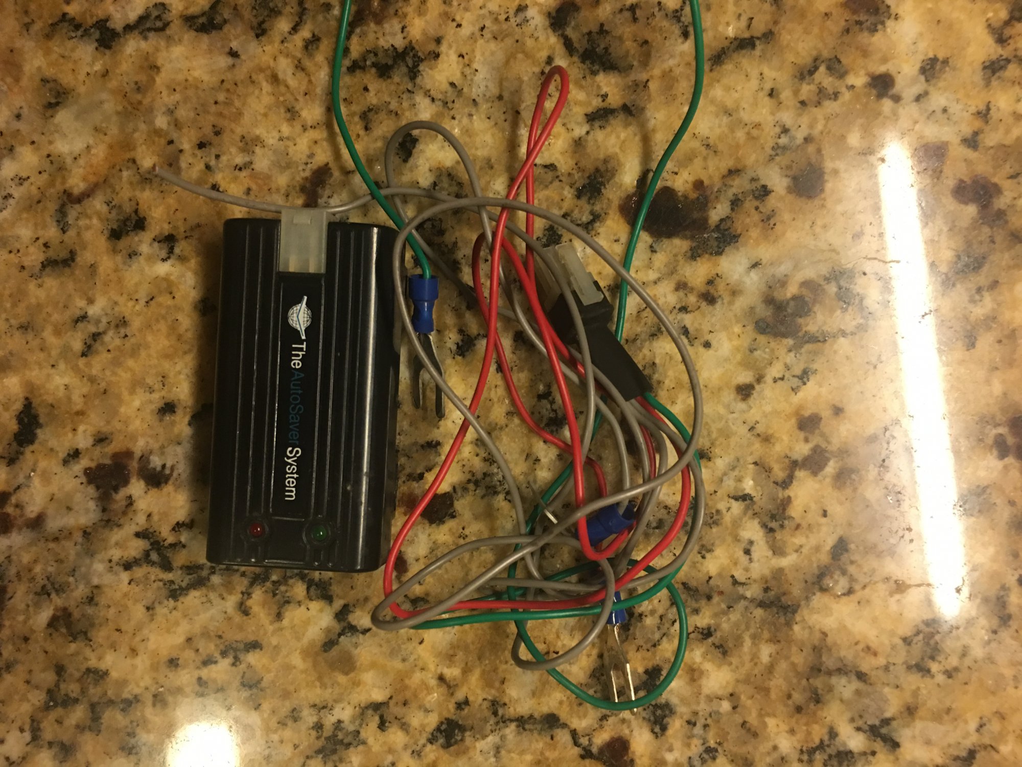

Thanks, but silly question since I am relative newb at this stuff.. is the ground system part of the 'bus bar' (for lack of better term) assembly on the top of the battery?  In other words, there isn't a direct connection, as in another wire aside from the main one, from the (-) terminal post of the battery to the ground, correct?  The reason I ask is I had this autosaver system installed at the dealer when I bought my truck new (to prevent rust corrosion but later found out it really is a ~$800 gimmick) that had a thin wire going to the (-) terminal post of my battery to what I assume was a ground, with the grounded end tucked inside some unreachable plastic/stripping area at the bottom of windshield.  I snipped it off, so cannot replace it.  I would hate to think this is relevant.
I completely removed this autosaver system when I installed my new AGM battery since it was a small drain on the battery all the time (small flashing LED) all the time.  JFYI don't ever buy this..turns out it really only works if car is completely submerged in water (as in if your car becomes a boat!).  I didn't realize this until a year or so later.

Anything they added to "autosave" is irrelevant. Snip away.

Thanks SkippyDog, you couldn't be more correct!  I originally thought was a rust treatment paint or something along those lines, not an electronic corrosion preventer..nothing like learning the hard way.
