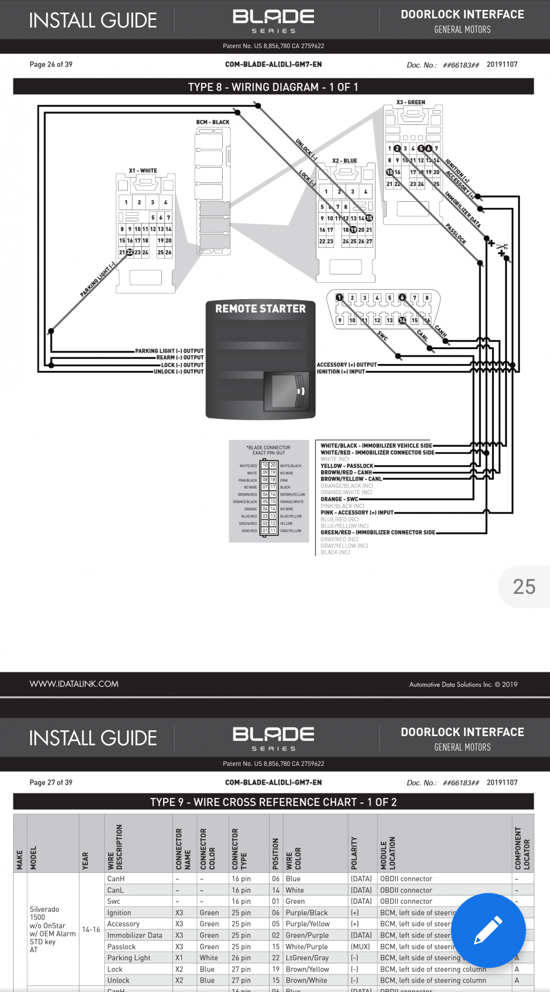

Hey!!...new here, but not new to Chevy trucks...has anybody retrofitted a factory keyless entry to a WT??...I hear there is wiring in these trucks for options, but if you didnt pay GM when you bought them, they werent installed..what other options can be retro fitted??
Keyless entry is simple.  Heres a diagram for the compustar blade and alarm. Btw welcome to the site.?
For factory options see when exiting the truck if pressing the doors lock and you get a ding. If so try getting the dorman programer and fob. That may be all you need. I suggest you go aftermarket due to theft
