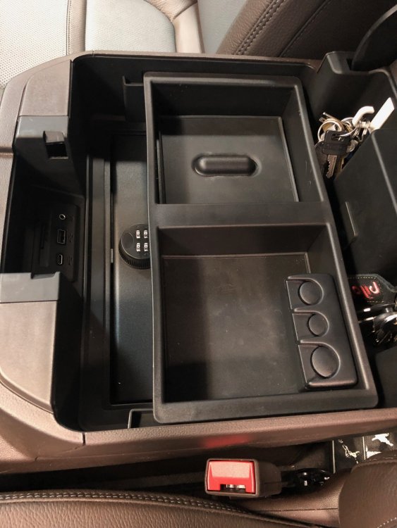

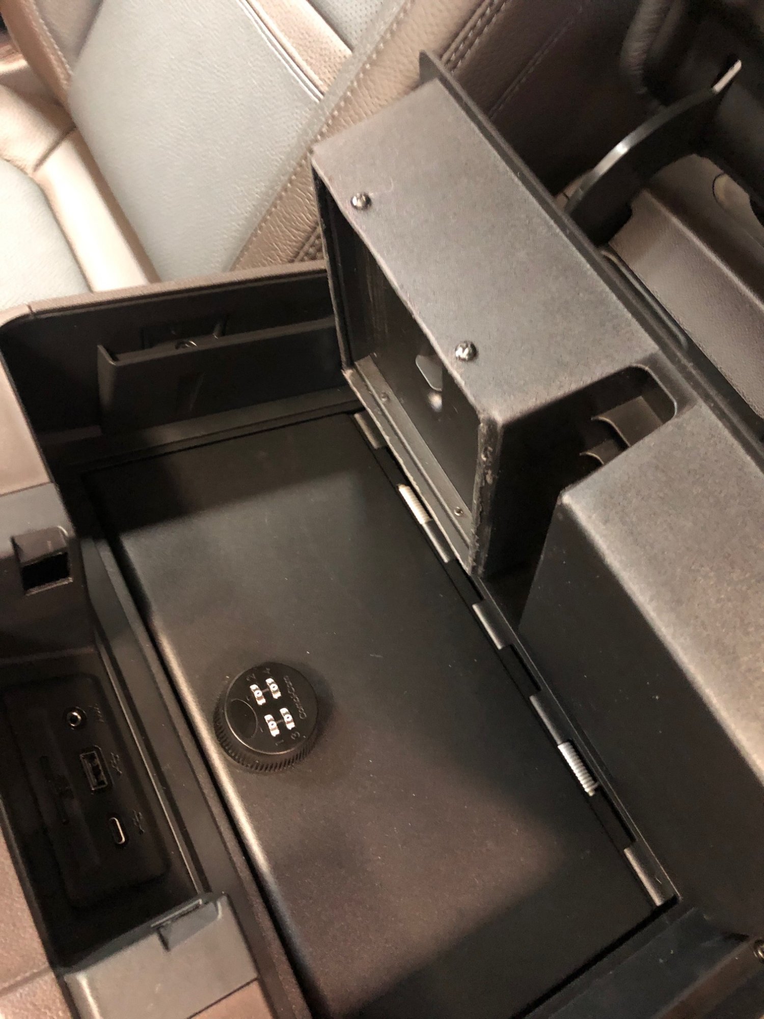

I owe a thanks to "Unit" for prompting me to get my vault out of the attic. I ordered it with the truck, but never installed it, as I did not want to lose a bunch of storage space in there.  I actually bought the organizer tray last week, and, as you may know, it has a shallow side and a deep side. I measured, and the shallow side would fit with the vault in there. I proceeded to cut off the deeper part and leave the "lip" for the false bottom so both sides would fit. I ended up added a few screws to hold it better.  Works great and gives me the storage and easy access I needed.  Probably a cheaper solution or better ideas out there, but I did not think I was going to use the vault when I ordered the organizer...

I like the key hooks you put in there, I think I'm going to do that to mine.

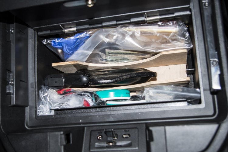

Since we're talking console safes, I'll show you mine.  I had Tomato talked into selling me his but he decided to use it instead, so I found another one.  I added a tab on the lid of the safe to help pull it open.  The spring on the lid is a little week and only opens about a half an inch when the knob is turned making it a little hard to pull open.  It's hard to get a grip on the combo knob, so  I drilled a hole in the lid and installed a quarter inch bolt with a flange nut turned upside down so that I could get a good grip on it.  Works better than expected.  I also made a divider so that everything isn't just piled in.  Makes it a little easier to find the things I need when I need them.  I hope the photos show well enough.  I also have a tray, not pictured.  Everything combined make a pretty useful console - I like it!
