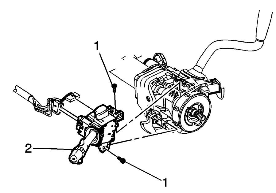

My 2006 silverado 1500 turn signal will not reset on left hand turns. I have tried searching every where and I can’t tell if this is the multi switch or if this truck has a canceling switch in the steering wheel like on my 92. Any info would be appreciated. Thanks

It is the switch. It uses the same cancel cam for the switch left and right. So if right is canceling it can only be the switch.

Thanks for the replies I figured it was the switch I just wanted to make sure. I bought a cheap one off eBay for cruise which also isn’t working so I will be sending it back.  I have a pick and pull by me so I will try that first.
