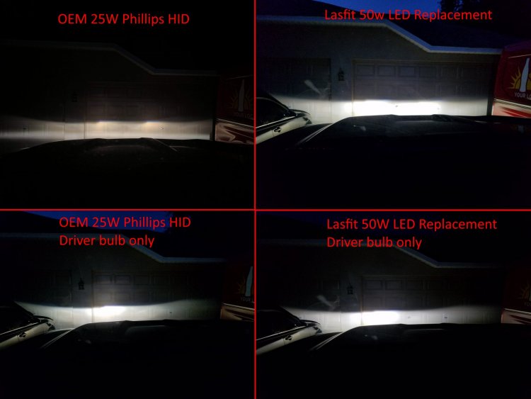

I just installed LasFit D5S LED's in my 2016 Silverado. Not exactly a retrofit, but it improves the OEM headlights DRASTICALLY. Check out my install video and comparison shots at the end. These are pretty cool, they come with a custom dust cover with a built in fan. The LED driver on the bulb also has a fan, so the two fans combined keep the inside of the headlight temps cooler. Link tot he LasFit website for reference: https://www.lasfit.com/collections/led-whole-package-for-chevrolet-silverado/products/custom-d5s-led-headlight-bulbs-fit-chevrolet-silverado-1500-2016-2017-2018

I installed mine on the 2014 and im not happy at all. Besides needing to adjust to get the best possible beam pattern, the light output is almost half of what i had with Morimoto HID setup.
I will be returning them and going back to the HID Setup. Im sure its the projectors in the 2014s that don't play well with LED bulbs. High beam was also weak. With the HIDs i can see a 1/4 mile down on a very dark road, its crazy bright.
