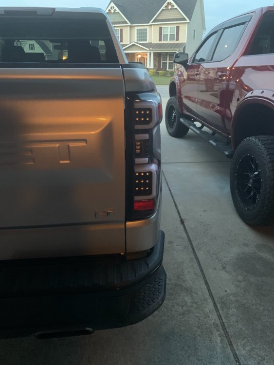

I just recently purchased a new 2020 Chevy Silverado 1500 Texas Edition. The truck came with the standard halogen brake lights. I purchased some new LED OEM taillights and thought it would be plug and play but quickly realized that’s not the case. The lights will illuminate but when I turn on the signal it flashes normal for about five seconds and then starts flashing rapidly. The dash screen also reads that there is an issue with turn signal. How can this be fixed? Thanks!!
They usually would have to install resistors to stop that

I put LED taillights on as well (With pre installed resistors on them) all lights work fine as well, but when I use the turn signal the same thing happens. If you fixxed this issue how did you do it. I have explored the internet for months on this issue and cannot find a fix!
Spoiler
I put LED taillights on as well (With pre installed resistors on them) all lights work fine as well, but when I use the turn signal the same thing happens. If you fixed this issue how did you do it? I have explored the internet for months on this issue and cannot find a fix!
Bro! I’ve been trying to crack the nut on this for a week... I thought you may be my savior. Same thing... 2020 Chevy with new LEDs... hyper flashing with the warning. Hopefully we figure this out.
