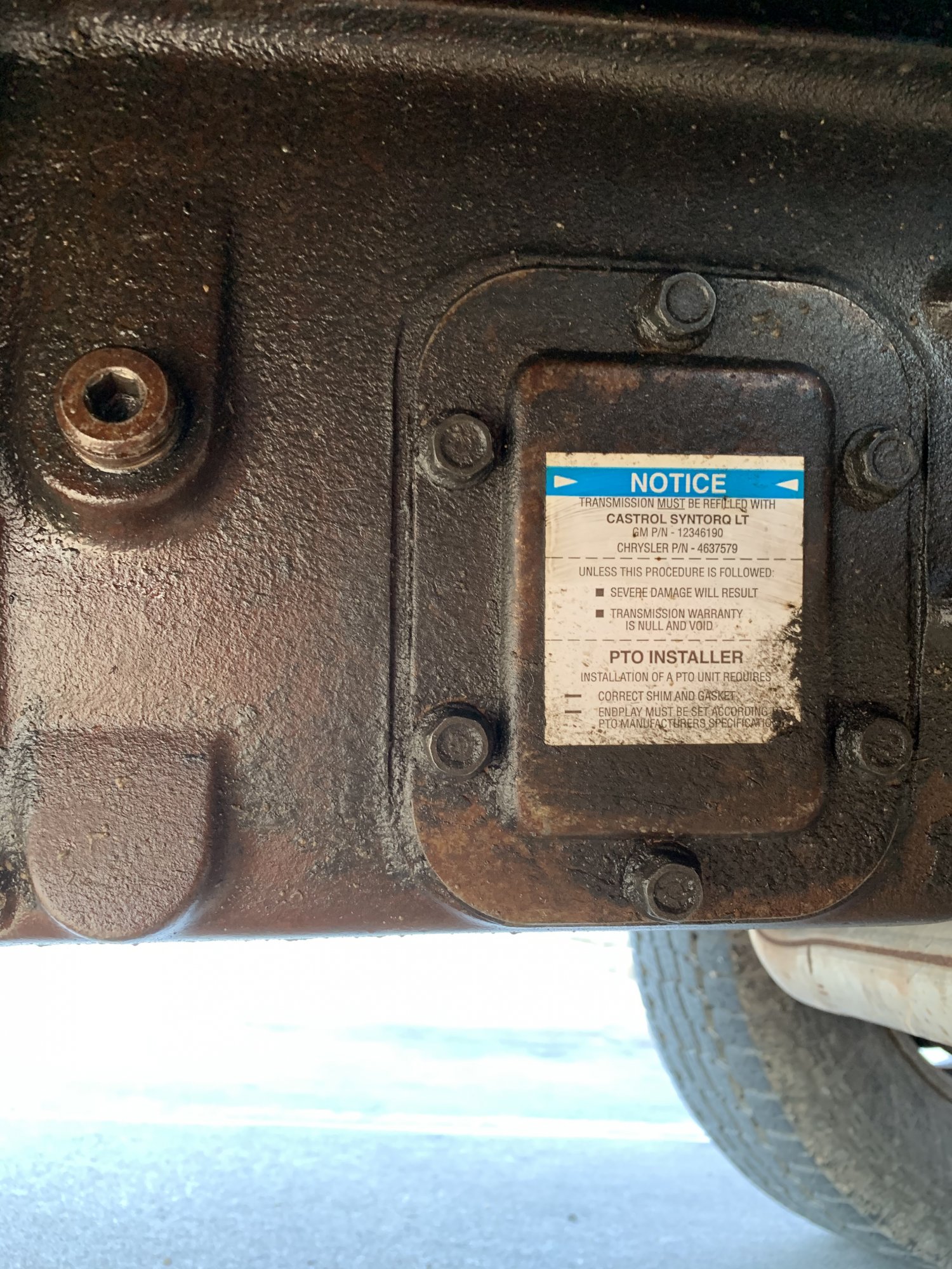

I recently purchased a ‘89 GMC C2500. 4 speed with overdrive? (L,1,2,3,OD). Transmission has been leaking some. Looks like from the top. I am wanting to change transmission fluid. Mileage shows 184,700. Odometer works intermittent. Actual mileage unknown. My question is what type of fluid should I use and how much? I have looked everywhere on the internet that I can think of and have not been able to find any definitive answers. Looking for any and all help. Thanks.

After a closer look, I believe my transmission isn’t the factor one. Would you be able to tell what you of fluid.
Didn't realize you had a manual transmission.  I assumed it was an auto when you said 4 speed with Overdrive.  That's one of the New Venture manuals and takes a very specific fluid, definitely not automatic transmission fluid.  You'll need the manual transmission fluid that these take, the new GM part # should be 19369226.  I believe there are only a couple of options left for fluid on these unfortunately, the Castrol Syntorq was discontinued some years ago.
