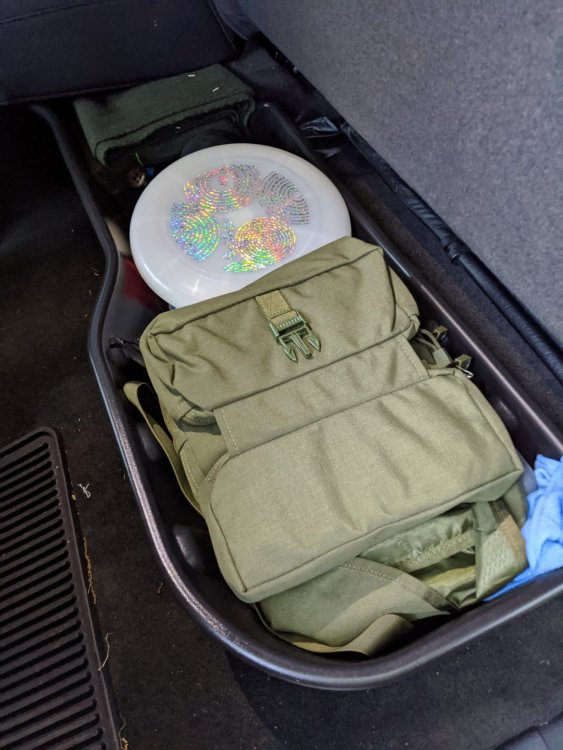

First thing I did was to install the oem underseat storage for the rear seats. I did a lot of looking around at the options for aftermarket storage and I was either wary of the build quality, the fit, or most commonly, the attachment mechanism to the truck. The bolted on brackets and solid fit of the oem system appealed most to me. I ordered part number 23183674 from eBay.
The only difficult part of the install I would say was actually getting the bolts tightened to a comfortable place. I don't have a torque wrench so I was just determined to power through the red loctite and get them as tight as I could. In the end, they still didn't seem to be in all the way, but I've had zero issues with rattling, moving around, anything like that.
Pictured below with my first aid kit, a blanket, frisbee, and a few other essentials. Putting together carry kits has been an obsession of mine for a long time. I'll have to document what all I carry here at some point as well...

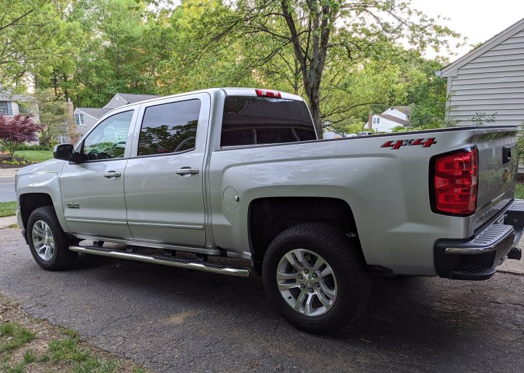

This next mod was a big deal. At 5'10, the truck is pretty much exactly the right height that I don't have to reach to get in or out of it, especially with the handles on the pillar. The shorter people who frequently have to get into my truck, they had some struggles. I wanted to make sure everyone who rode in my truck has a good experience, not just me. And now that they're in, I'm not hating the extra comfort myself.
I must have looked through hundreds of step bars while looking for these. In that process, I learned two things: 1) I wanted something with rounded or no edges. I have too many shin-scraping childhood memories of my mom's Jimmy and its running boards. 2) Wheel-to-wheel step bars exist and holy ****** why would anyone get anything else. Being able to reach into the middle of the bed from the side? Yes. With those two criteria in mind, I was able to narrow it down pretty quickly to the chrome beauties that are the Westin ProTraxx 5 Wheel-to-wheel Bars I bought from RealTruck.
The install took me the better part of 6 hours on and off. I think if I did it again, I could get that down to about 2. The instructions that come with these things are cryptic as hell and involve a lot of flipping back and forth. Without this video from Midwest Aftermarket, I think I would've been in real trouble. Something they gloss over though, is how much trouble one particular bracket on each side will give you. One bracket on each side is unique and it's here to ruin your day. Most of my 6 hours was spent loosening and tightening pieces here and there trying to coax the unique bracket into place. In the end though, everything fits very securely with no drilling, the height is perfect, and as a fan of classic cars, I'll rarely say no to a little more chrome on my ride.

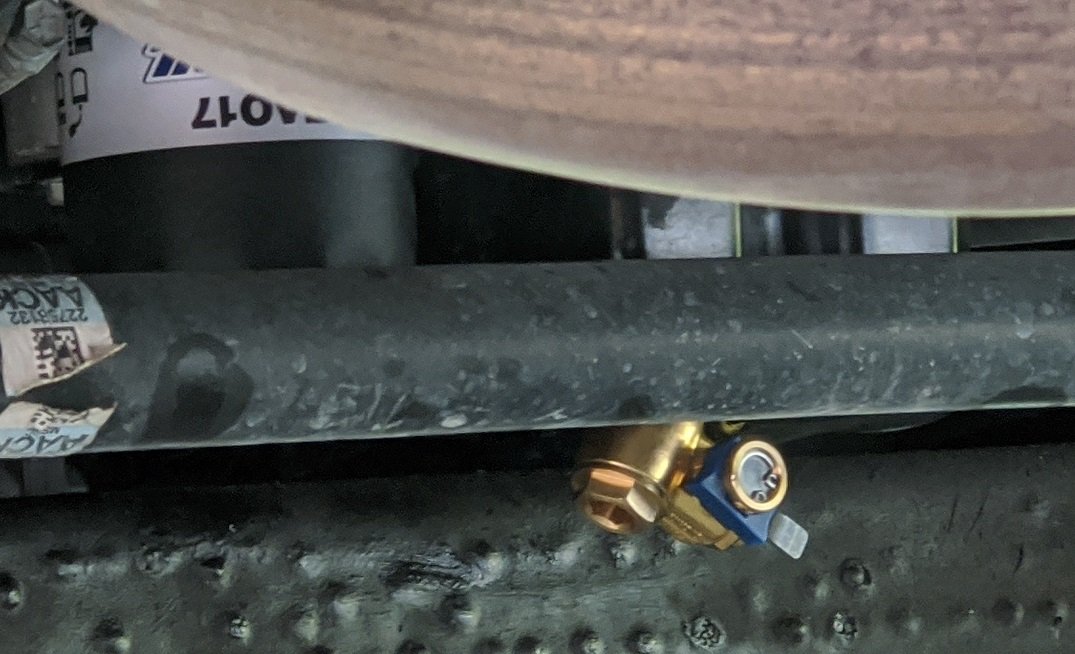

I've always been one of those guys who comes out of oil changes with my hands looking like Swamp Thing. When I came across the idea of the Fumoto valve in one of the mod threads here I couldn't believe I'd never thought to look into something like this before and that I'd never heard of it. After checking way too many times that I was getting he right one, I ordered the F107SX Fumoto Valve.
Installation could not have been easier. Literally just put the plug in where the old oil plug went, orient the valve where you want it, call it a day. The clip to retain the valve lever is a little fiddly, but I got it. Really looking forward to my next oil change to see how well it performs. Now just need to figure out how to stop getting swamp hands from changing the filter...

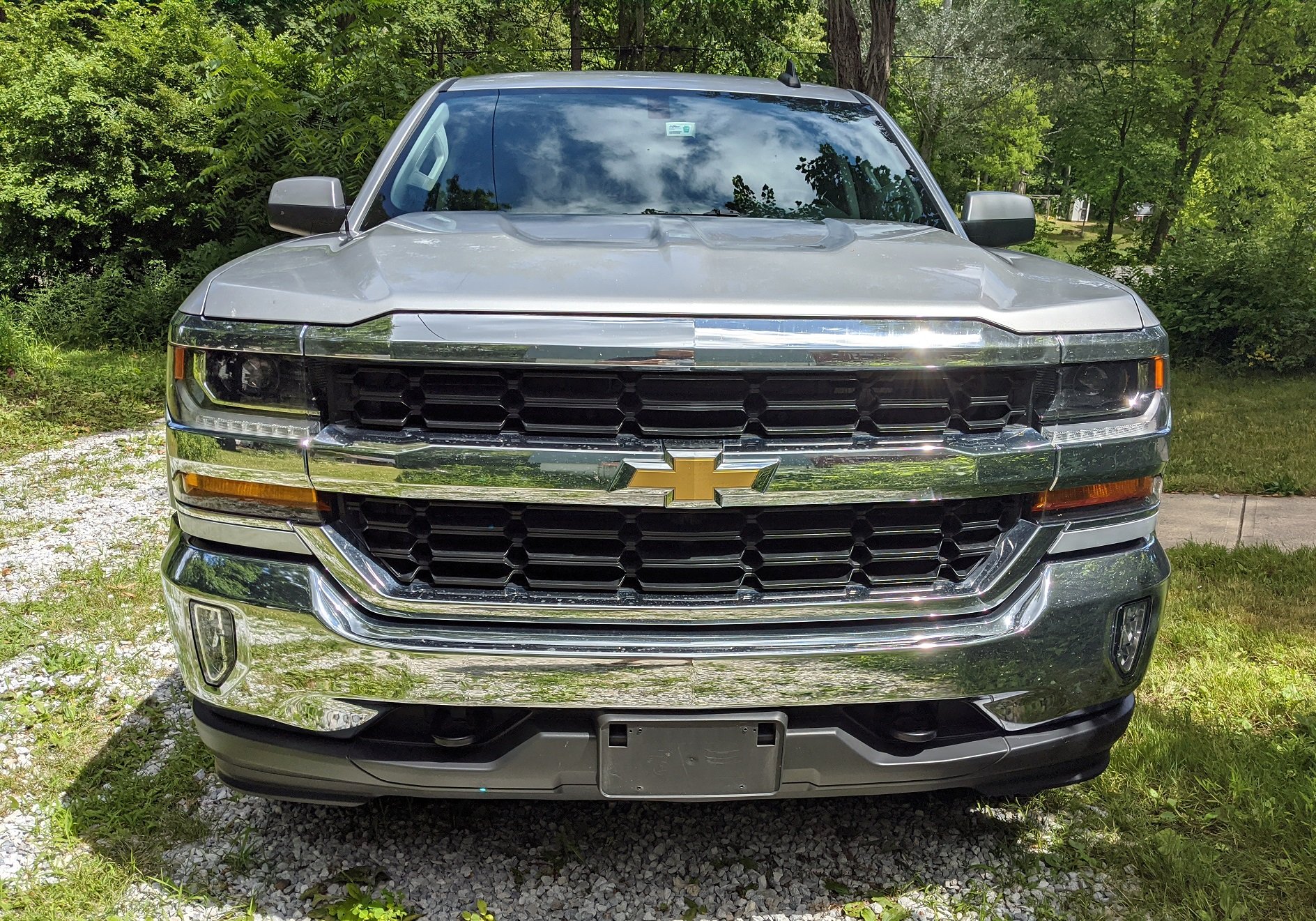

After moving to a state that doesn't require front license plates, you know damn well I was taking advantage. I've always thought that my plates were ugly - there's no way I'm displaying them any more than I'm 100% required to.
I was hoping it'd be just a couple of screws, but no such luck. This thing was held in by three rivets. Luckily, they were made of tin or some other equally weak material and I was able to drill and pluck them out pretty easily with just a regular cordless drill and a pair of needlenose pliers. I need to get my hands on some filler for the holes, but man, removing that plate does wonders for the lines on the front of this baby.

The piece that has the holes in is referred to as a skid plate, you can just replace that section.
May be an easier way to go.
Truck does look good with the plate holder. Maybe hang onto it, there are members looking for things like that every once in a while.
Edited by JimCost2014
Definitely hanging onto it. Never know how laws will change or if I'll end up moving again...

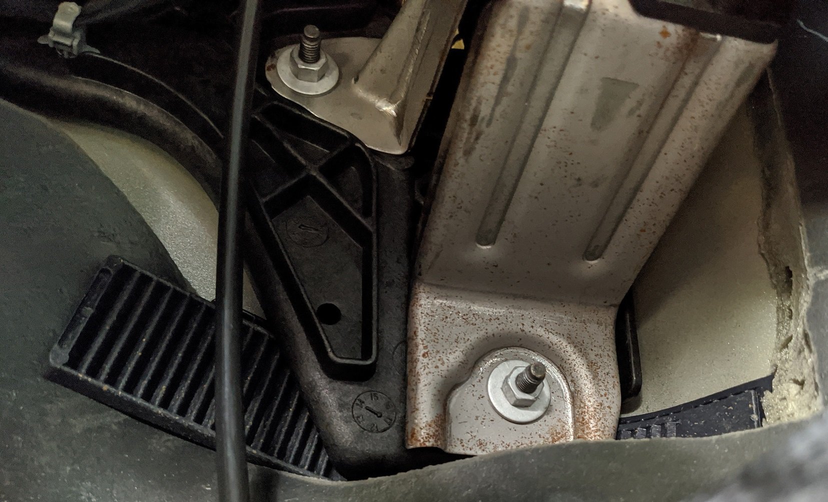

Like I think most people with our truck, I'm pretty disappointed in the throttle response. There's a lot of travel before anything engages, it's generally slow to respond overall, it feels like an SUV or a van instead of the powerhouse it is. I've read a lot around here about the so-called "paint stick trick" wherein you put a paint stick or something similar behind the plastic plate that the accelerator bolts to, this reduces the flex that occurs when you step on the gas, and increases throttle response. Really nothing to lose here, so I picked up a pack of composite shims at Home Depot for a couple of bucks.
When I moved the seat and carpet back and got down there, I noticed that I didn't see any flex when pressing the accelerator. The pedal gave way long before there was any motion in the backplate. That said, I could move the plate a fair distance relatively easily, so I went ahead. I did a test drive first to get the feel of the accelerator fresh in my mind, wedged two shims behind the plate, went for another drive and... didn't notice anything. It feels exactly the same to me. I don't know if this is worse in older models and had been mostly remedied by 2018 or if I did this wrong, but I can't tell a difference at all. Still, good to know for $2 and 10 mins. I'll pursue an electronic throttle controller solution at some point, hopefully with better results.
