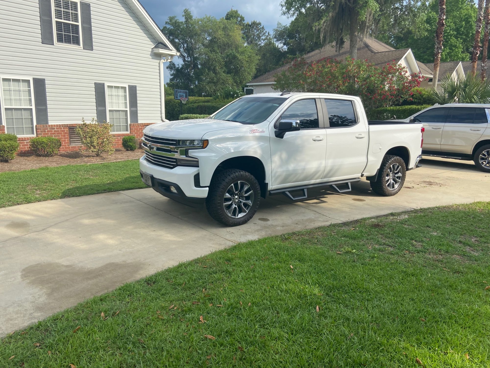

I have the 2.5 Moto fab top mount spacer on my 2020 Sierra crew cab. I originally installed the Rough Country bottom mount spacer but removed it and installed the Moto fab due to clearance between the CV boot & the strut bolt. Only issue I had was when you mount the spacer to the strut you have to rotate the strut 180 degrees when reinstalling. This causes the tabs that mount the strut to the control arm to be angled in the opposite direction making it impossible to thread the bolts in. I took a large adjustable and rotated the tabs to match the angle of the control arm. I saw where the Rough Country top mount spacer disassembles the strut and rotates it 180 degrees. (Check their website) Looks to correct the angle of the tabs when reinstalling the strut. I also installed the rear factory spring blocks that I removed from my 2014 Sierra and have about a 1 inch rake.
Your truck looks great, I want to do the same. What are your front fender measurements from the ground?  Mine is 38.5 driver and 38.75 passenger. Not sure why it’s uneven.
No issues with your cv angles?
Thanks!
Thanks for the compliment! Believe it or not I have the same measurements taken at the center of the wheel ground to bottom of the fender.
Don't know if yours is a Silverado or Sierra and measurements would be different? My tires are stock 275-60-20 @ 38PSI. I ran a 2.5 inch Rough Country lift on my 2014 Sierra for 5 1/2 years with no problem with CV joints. I have 3500 miles on this truck.

Mine is a 2019 gmc X31 with 275/60/20’s also.
