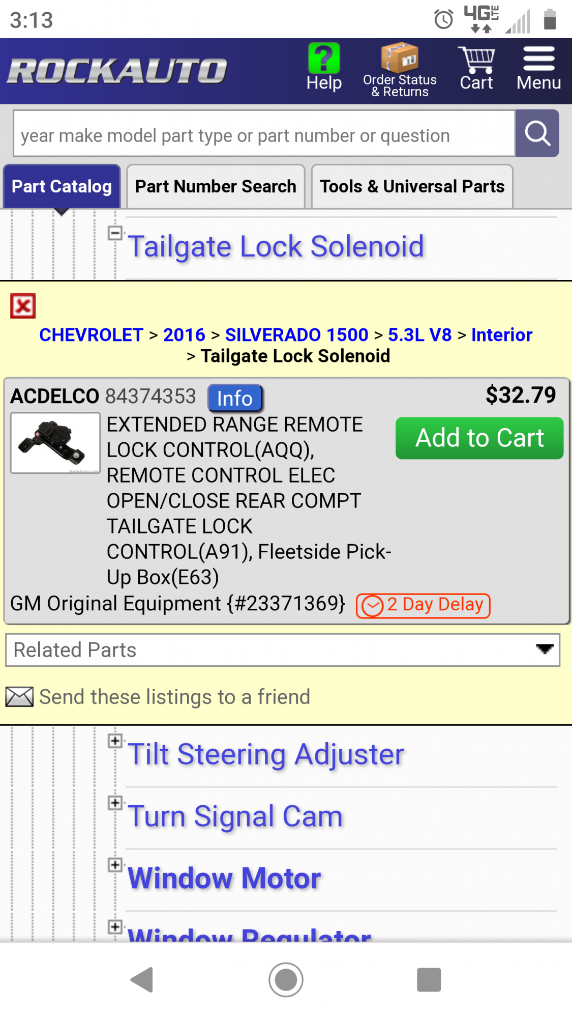

This is what I found for a 16 on rockauto
So did you order the solenoid and wire it up to work? I have a 2014 and would prefer the stock later model unit without having to buy an entire tailgate from a 2016+. Wouldn’t mind the pop-a-lock, but have heard that they can be finicky.
I did not. I opened my tailgate up and it does not have the mounting provisions for the stock actuator so I just ordered the pop and lock. Actually just hooked it all up tonight. Seems to work pretty well. Of the dozen or so times I tried it I had a few that it didn't actually lock but I would say 8 out of 10 it did. Just seems like it needs a hair more travel to get it every time.
I also installed the Pop & Lock in my truck. The install took about 20-30 minutes from start to finish and works flawlessly.
