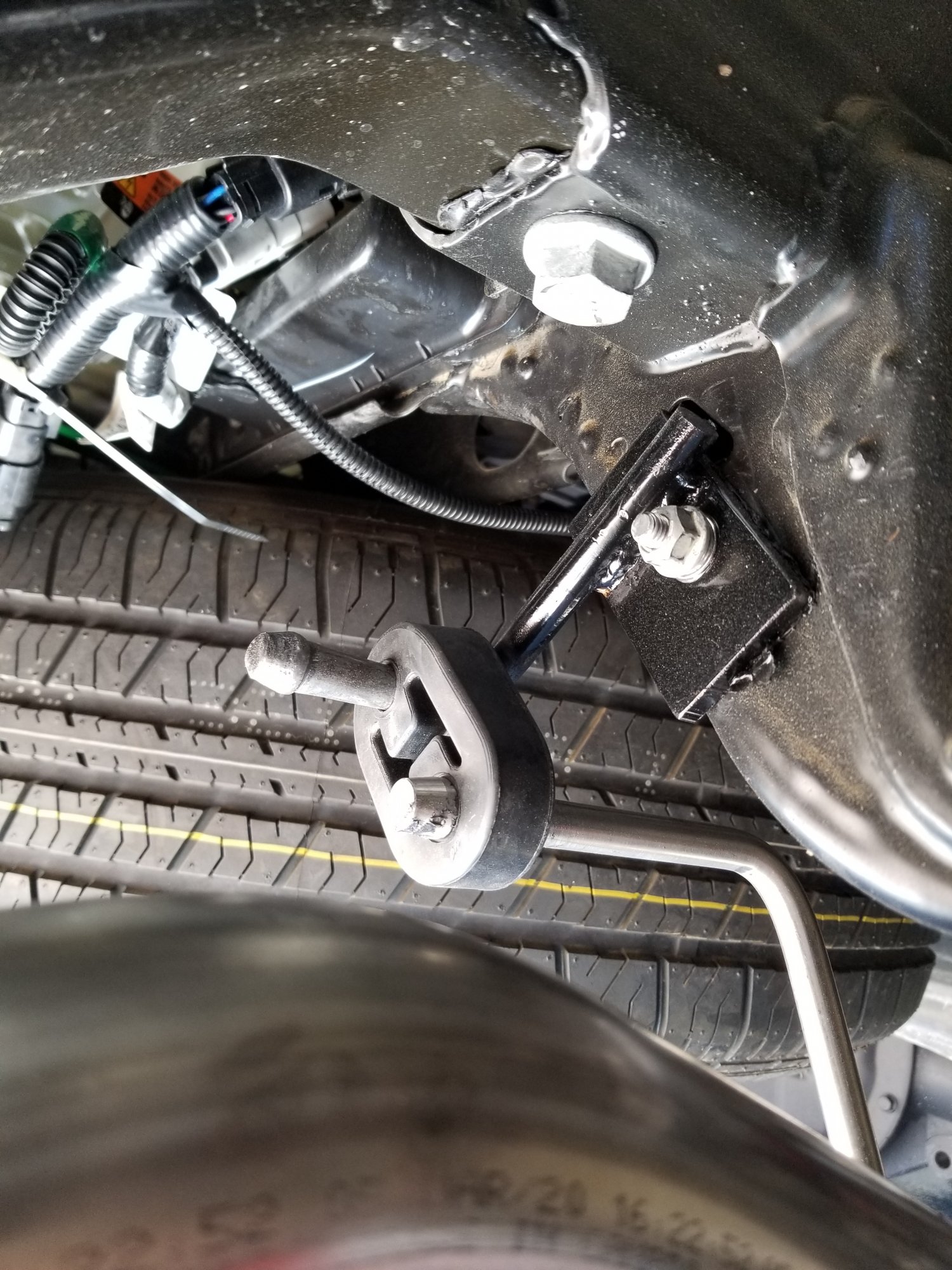

I did it about 1 month ago. I ordered a corsa 21028 cat back kit, which at the time I purchased they had a $125 rebate so it was free shipping and a rebate. The dual corsa system matches up with the frame but I had to weld up my own exhaust hangers for the rear exits. The truck is also missing the driver's side heat shield for the spare tire but I opted to use titanium exhaust wrap off amazon which is far cheaper than the stock heat shield. The rear bumper actually has the cutouts for the chrome tips on true dual exhaust trucks but you would have to change out the bumper cover I believe and buy tips as well. The corsa system exits as a slight down angle so I felt that enough to clear the bumper and exit nicely. No need for tips, forcing my wallet to diet was taking its toll....you'll need 1/2 exhaust hangers which I got off ebay and the rubber exhaust hanger itself also off ebay.
Overall it turned out great, sounds great, with the GM cold air intake and thier recalibration, I swear the truck is a whole different animal now.

Did the dealer say why it wouldn't work? Length of bed? Crew cab or double cab? I have a double cab with a standard bed. They may also be saying it doesn't work because your rear bumper isn't configured for it. I took the chance with the dual rear knowing I was going to fabricate my own hangers so I could drop the exhaust lower than my bumper. If you know someone who can help you do that or if you're in Vegas I can help you out. Go with dual rear, you won't regret it.

Sorry I think my pictures are too big to upload. I hit the limit. PM me and I can send more. My truck doesn't have the parking sensors and I don't have any wiring above the exhaust. I'm not sure I'd it made a difference or not but I installed the factory GM 2" lift kit also.
