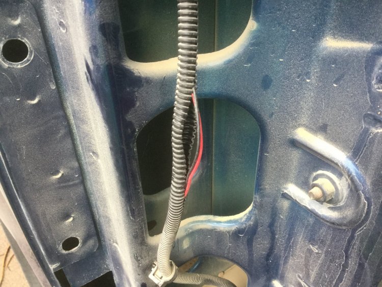

There is also a separate harness with two wires that go the the bed lighting.  I think I can just splice the dome light into these two wires; but don't know which is hot and which is ground.

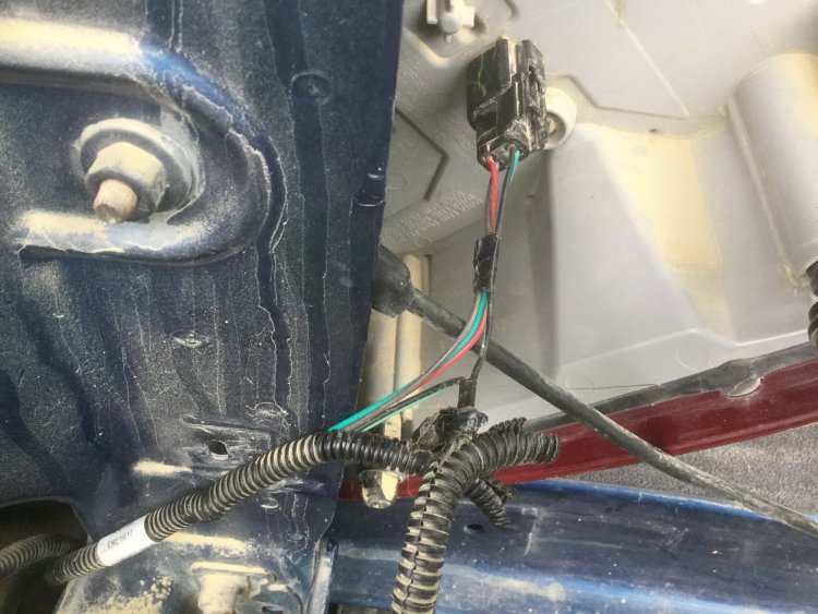

well I pull the light housing today.  not sure where the X400 connector is.  I thought it would be the c connector to the bulb in the light housing.  i am not sure that is the connector as I don't see a dummy spot.  There are 4 wires there.  one of those spots doesn't seem to have any power.  my guess is that would be the ground, is that so?  So is there  one wire that is dedicated to the brake light only?  I can't seem to determine which one to use so the brake light doesn't blink. I will take some photos and post.  I think the black is the ground.  Don't know what the red, green, and brown wire do.  Or where the x400 connector is located if this is not it.
Confused by instructions,  is the X400 connector in the light housing.  If this is it my has 4. Wires, a black I think and a red, green and brown. Here is a photo hopefully.
