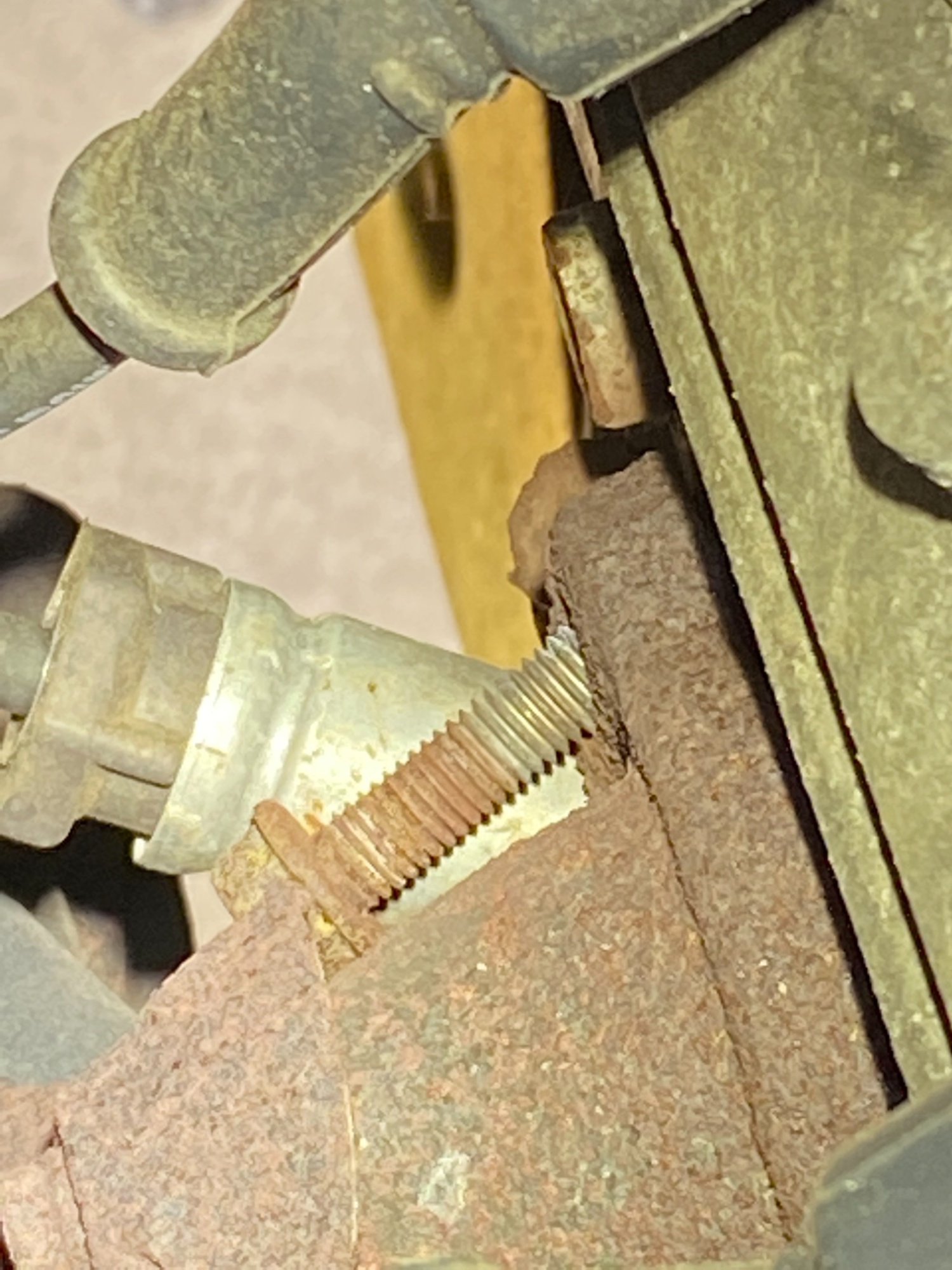

I got a wiring diagram for the engine harness. I traced the wires to the o2 sensors and they are all fine. I get good solid ground and power to all of them. Bank 1 sensor 1 is holding stead at 1275. I believe that is my issue that’s throwing it all off between the 2 banks. The sensor is good. I took it for a drive and the sensor started reading about the same as all the others and it was fine and then shot back to 1275 and stayed flat. I’m wondering if I have a leaking exhaust manifold and it’s sucking air, thus making the sensor readings wrong.

Found some leaks. Both sides of the exhaust are leaking where the y pipe bolts to the manifolds. Had the trans rebuilt so the y pipe was removed. Also found the rear most manifold bolt on the passenger side totally backed out.
Well that could cause it. But it would lose air, still cause it to be out of spec though! The fuel for that side would just be up

It does have some exhaust leaks. Mainly on the passenger side. I removed the computer and used fiber optic wire cleaner and a brush and cleaned all the connections. Now it’s running good. But sensor one is flat lined at 1275.

It can.  I know on my truck, which had 6 broken off bolts when I bought it, the O2 sensors indicated mixture was very lean until I fixed them.
