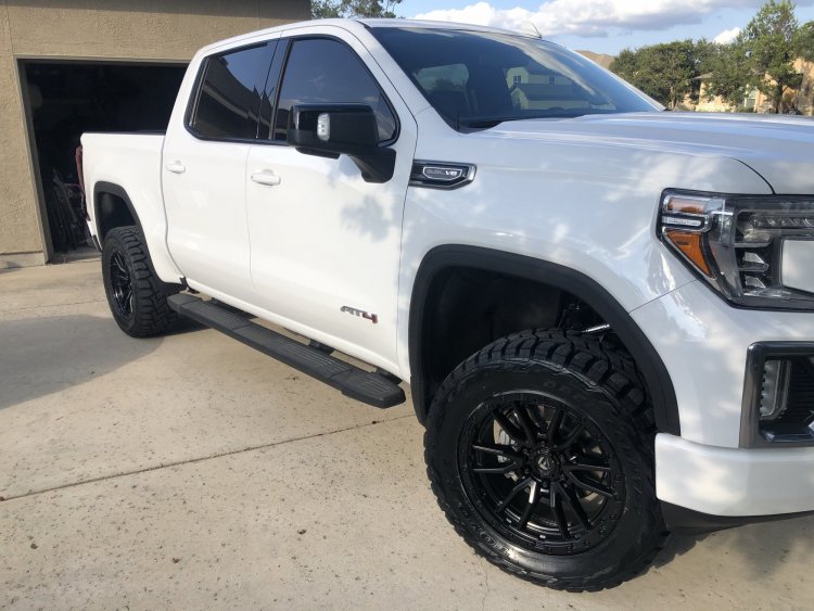

Idk about the ones in that picture but mine is similar...
2020 at4 1500
Readylift sst kit 2"
Fuel Coupler 20x9 +1
Falken wildpeak at3 305/55r20
Slight rub at full lock. Did some minor triming and pulled back wheel well liners and now it clears.
2020 at4 1500
That looks awesome man, love the look ! Thank so much for all the details. Wheels look like they stick out father than I would have thought for +1. Just roughly how much do you figure they stick out?
Not much which I'm happy about so I'm not slinging rocks all over my paint lol still enough to notice them.
