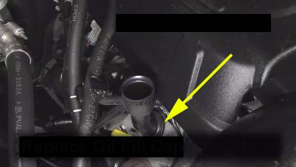

Added a quart this morning and noticed for the first time that the oil filler spout rotated about 5 degrees left-right at the point where it attaches to the block. I did not see any way to tighten it - no set screw, etc. Should I be worried? Will be watching it closely over the next few days. Thanks in advance.
There is no way to tighten it, and there is no set-screw, it just basically "snaps" into place, just turn it to the right until it stops and it should be ok. If not it may be cracked or broken on the bottom where it screws in.
