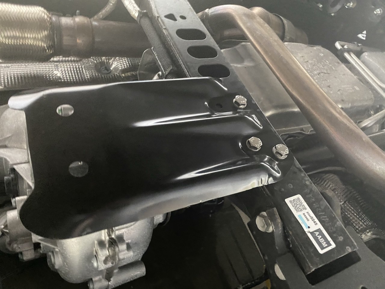

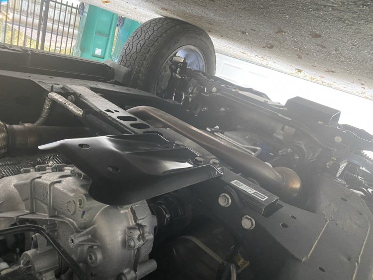

The transfer case skid plate works but you need to install rivet nuts in the factory holes!

Oh I should add M12 is the rivet nut and bolt size
