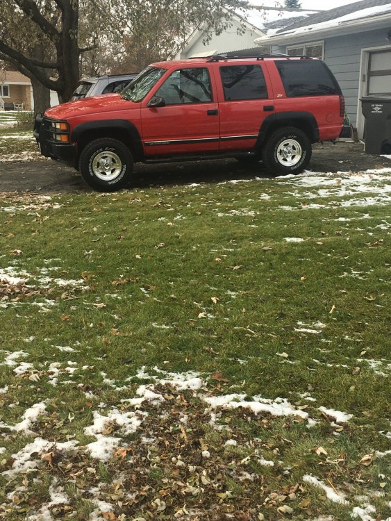

I have a 1999 Chevy Tahoe with about 270,000 miles on it. I have the 5.7 vortex engine with l460e transmission.
move noticed my transfer case is leaking fluid.
I don’t often use it in 4wd but the fluid is coating everything behind it.
I it’s my tow/haul vehicle so it sees about 12-15k miles max a year. (Not a daily driver)
move just put a lot into brakes/suspension/axle seals etc and am wondering if a used or rebuilt unit is the better option?
I guess first I would need to know Which case I’m looking for?
thanks in advance.
