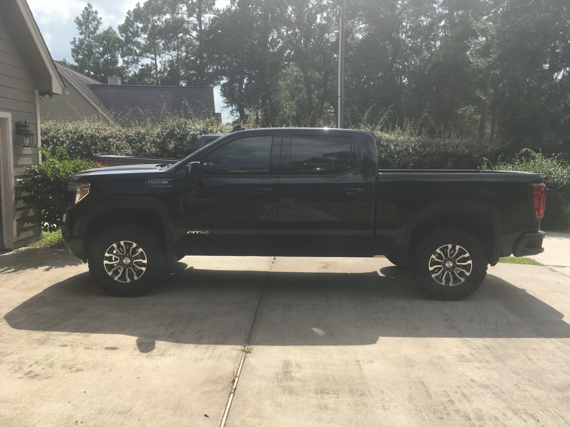

On 9/4/2020 at 4:43 AM, BetaX said:
I'm on that size tire but have the 2" SST. Very minor rubbing when turned going over a bump. Normal conditions, nothing.
What wheel offset?
No good ones but here you go.
285/75/18 Nitto Ridge Grapplers
Stock 18s
No wheel spacers
Zero Trimming.
Zero way to go any wider of a tire without hitting the Ready lift UCAs unless wheel spacers are added, which will probably cause more rubbing issues.
Only rubbing as mentioned above (Slight rub going over a bump at full lock)
Truck has a 1 to 1.25" rake with the 2" SST.
Edited by BetaX

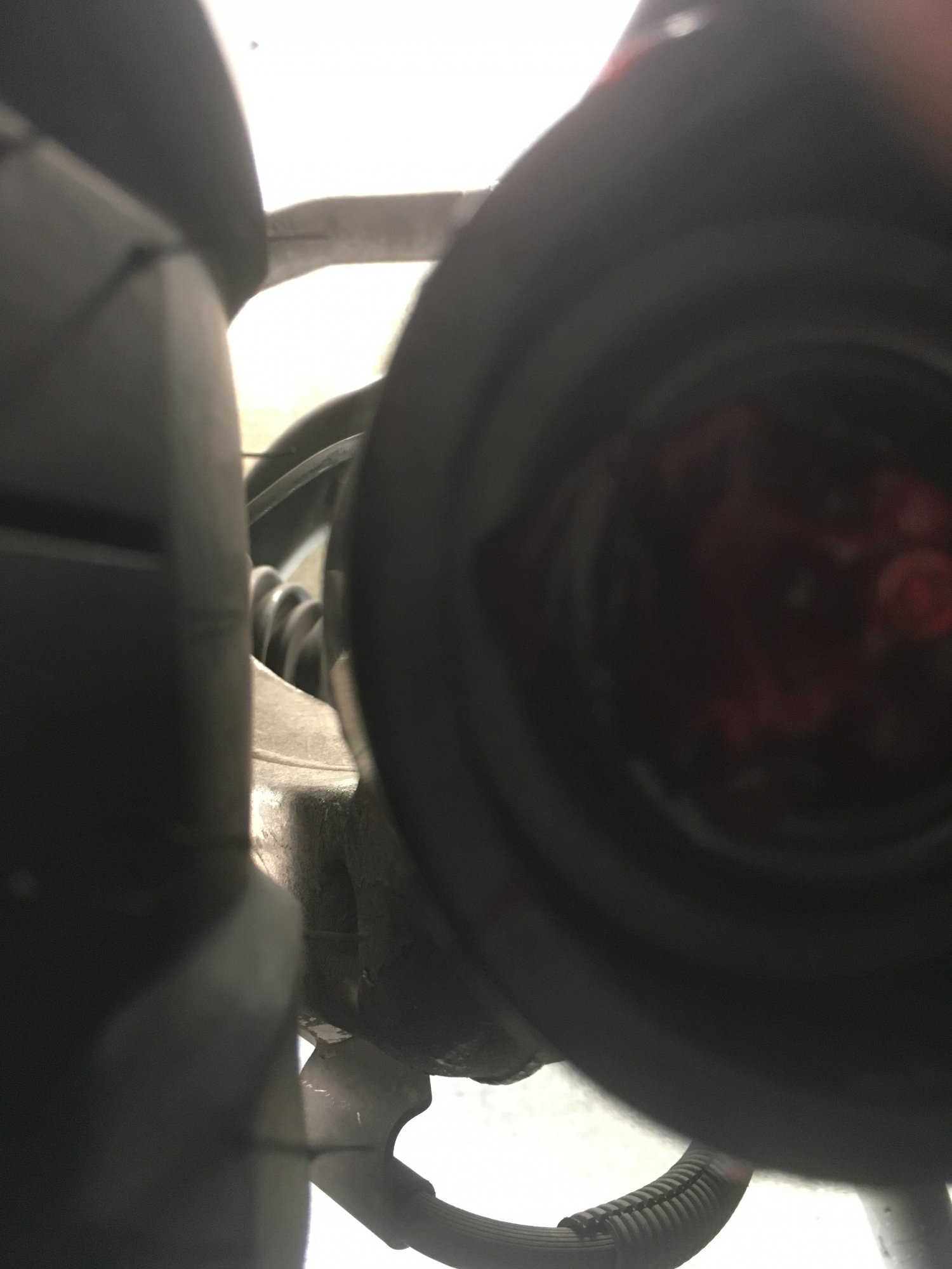

Here is my 2019 with same Ready Lift SST kit.  Also some photos of clearance of stock 275/75/18's on  on Method NV's which are a 12mm offset versus 26mm for stock.  So 285's would be very tight with RL UCA - but there is more room with stock UCA's
IMG_8828.thumb.JPG.4eea0193c4acb8c3ede59614fa68c684.JPG820113448_UCAGAP3.thumb.JPG.e8d86b6b8438931edd4234f266b76d86.JPG
For reference, here is my tire clearance with the RL UCA (Tire specs in above post).
Note that the outter lugs on the tire are not offset in the image so clearance is less than shown.
I've articulated the suspension pretty well to check for rubbing and haven't caught any marks yet but it is certainly close.
I'm convinced on this size tire, it will 100% come down to actual tire selection and not all 285/75/18's will fit without wheel spacers.

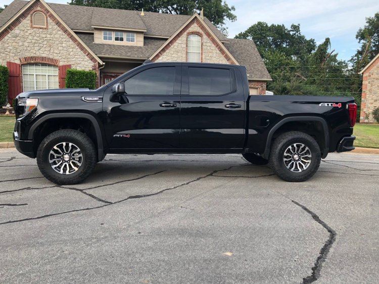

On 9/4/2020 at 6:23 AM, Trailboss91 said:
Anyone successfully put 285/75r18 tires on a stock AT4? I am looking at this size in the Falken Wildpeak AT3/W, they measure out to 34.8” tall and 11.2” wide.
They'll fit fine as long as you only drive in a straight line.  You WILL HAVE rub with the inboard front fender liner and "probably" in the rear of the fronts at the mud flap and/or liner.  I just installed 285/75/18 on OEM wheels on my AT4 with the Rough Country 1318 - 2" leveling kit and they just clear at full lock and no articulation.  I imagine if the suspension is heavily loaded while off-roading and near full lock I will rub the fender liner on the inboard side in the front.  It's really close without any articulation.  Tires I installed are the Toyo Open Country AT3 in 285/75/18 which are 34.8" x 11.3".  If I do rub it will be minimal and I can get a little more room if I zip tie the liner back as many have done.  Anything wider than 11.3" would cause me problems.
