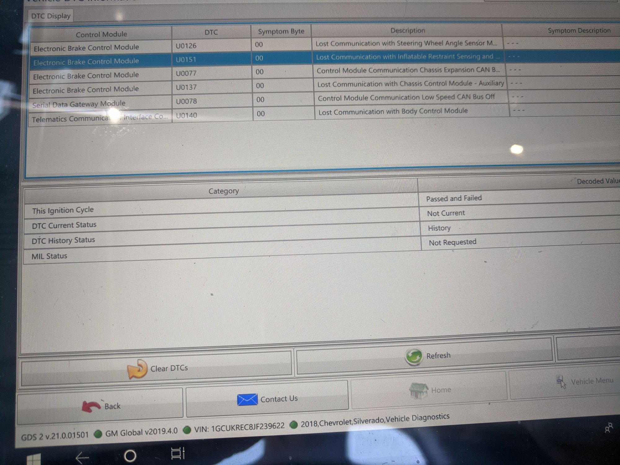

on my 2018 Silverado I get
radio codes only no HMI codes
u0028 most bus
u0140 lost communication with bcm
u0164 lost communication hvac
b1325 high voltage
ebcm codes
u0126 lost communication steering wheel angle sensor
u0151 lost communication inflatable restraint system
u0077 control module communication can-bus
I can clear all the codes from history, sit there and scan it on the same session and get no codes
drive it a little bit turn it on /off scan again
little by little within a few minutes the codes creep back one or two at time
all will come up as either history or passed and failed
no open code

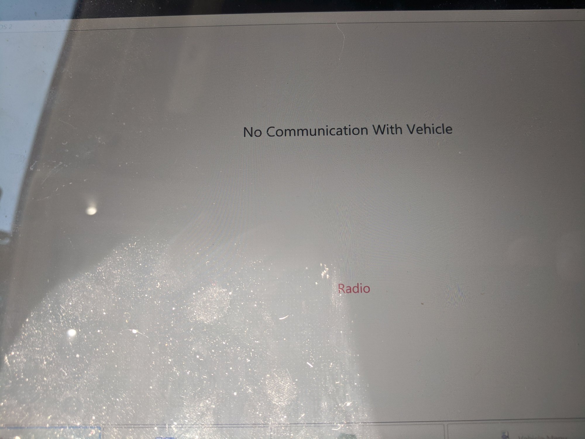

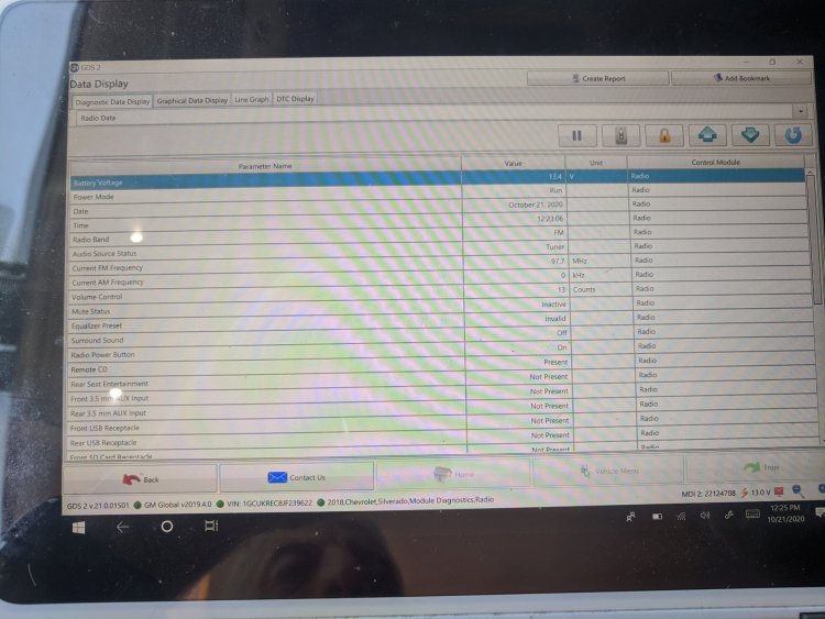

on different sessions I loose complete communication with radio and most of the modules, while those communications are down the ebcm is flagged and serial data gateway module is flagged, hmi is green, bcm is green and power steering control & transfer case module is green
the dealer is hesitant to do anything because i have aftermarket equipment installed such as a alarm system, hid lights, led lights
here are a couple photo's showing how I get intermittent communication, works and then it doesn't work
vehicle has no cel, drives and runs great, radio gives me intermittent problems, but these other codes are unrelated and should not even be coming up
No dealers for that stuff. You need a shop that specializes in this, or a mobile electronics troubleshooter / programmer (reflasher), or spend some time yourself looking over harnesses.
When I get a vehicle with a bunch of codes like that, regardless of what systems are affected, I do a visual inspection of the wiring near any common failures. Many times I'll find rubbed-through shorted wiring, a green crusty connection, or something else that's out of place. If that all checks out, then I'd be focusing on the alarm system. Some installers are HACKS. 9 times out of 10, the problem is related to the installation.
