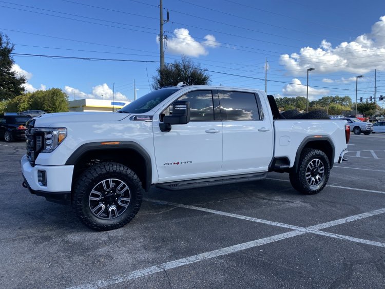

My AT4 went in the shop on Thursday to have my Cognito leveling kit installed and the installer said to go ahead and get my 37's mounted before I dropped it off for the lift. So before I had my tires installed, I just cranked the torsion keys up and to my surprise, the tires only had minor rubbing on the wheel well liners. Very minor trimming of the liners or maybe even pulling them back and securing them with zip ties and you can easily run 37's.
This picture is with my 37's and torsion bars cranked up

Looks great, Gswift!  I was going to say that it sits level as is but then I saw the tires in the back!  LOL
It did sit pretty level as is, but I had to turn the keys up all the way just so the tires would clear for the drive from Discount Tire to the Off-road shop which hurt the ride quality. I have the Cognito 3" Premier leveling kit that comes with their upper control arms and Fox shocks, so it'll be a little taller and ride much better.
