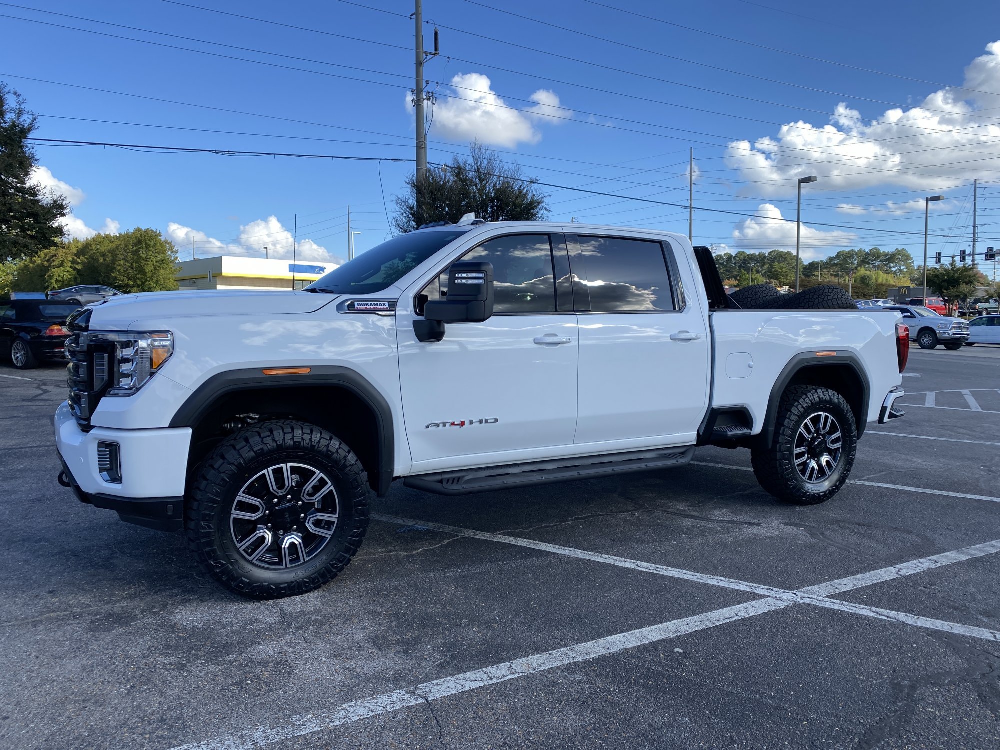

I went 37's on stock wheels. Got the Cognito Premier leveling kit being installed as we speak.

So this pic is after level installed? And those are the 37” tires? Any rubbing issues? Looks to be set fairly level huh..

I highly doubt the 37s on stock wheels will clear the control arms. my 275s on stock wheels are about 1/4" from the edge of the cognito ball joint pocket. any wider tire on stock wheels would rub.
let us know how it works out. post pics ??

This picture is with 37's and the torsion bars turned up, no lift kit yet. It didn't rub on the stock control arms, not sure about the Cognito arms. Truck should be done tomorrow, so I guess we'll see. If it does rub, I have a hub-centric spacer i'll use.

With stock control arms the 37's worked fine and only rubbed the liners. With the lift and the Cognito control arms, the 37's cleared the control arms by 1/4 inch with the wheels straight, but when it was near full lock the tires rubbed the control arms as you stated. So I pulled off the wheels and mounted my billet 1" wheel spacer and now clear the control arms perfectly. All it needed was some trimming on the liner and the mud flap.
As far as angles go, I end up buying the SuspensionMAXX diff drop. I don't really think it was needed since I only lifted slightly less than 3", but it probably helped get them slightly flatter.

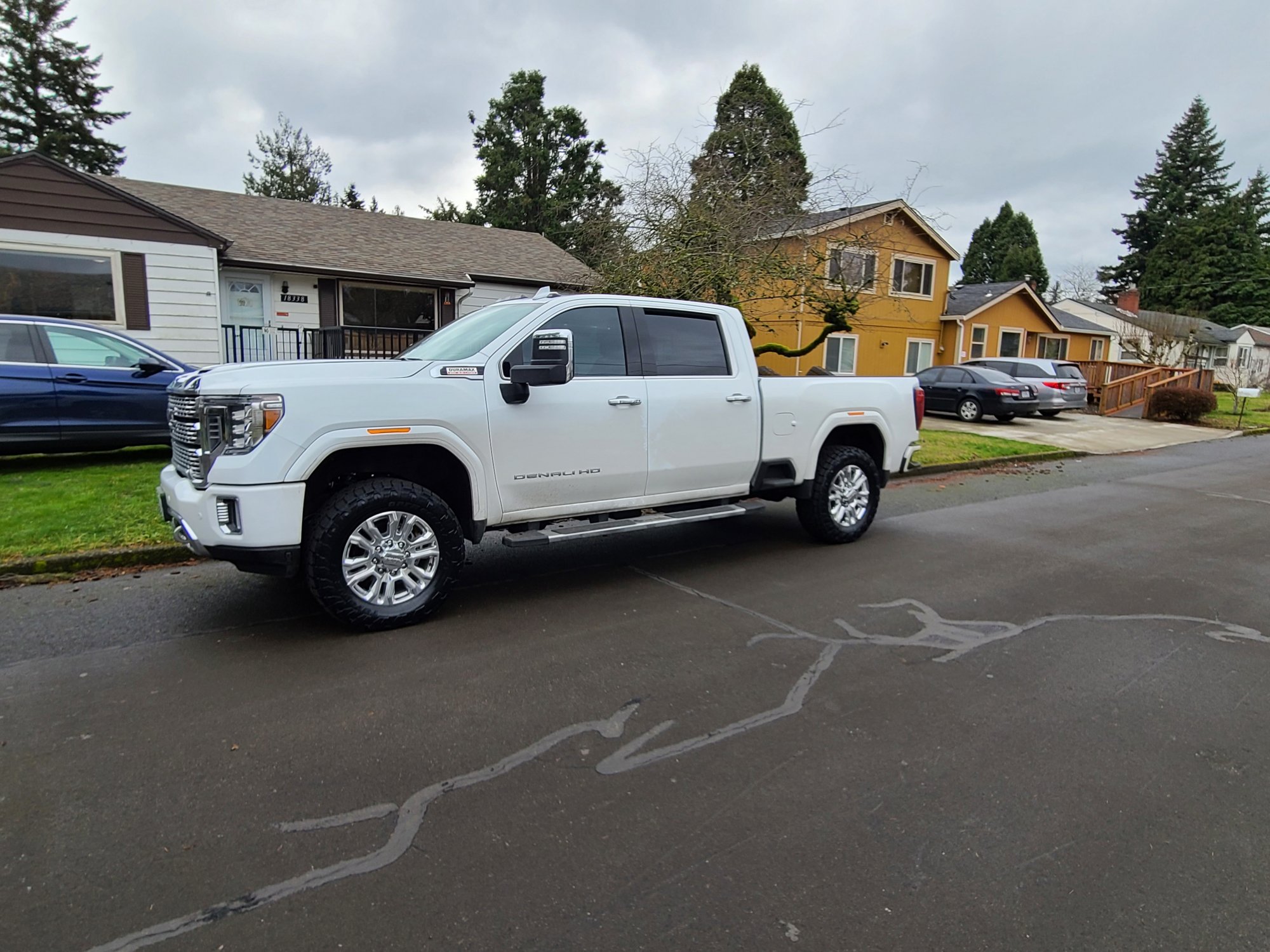

Well I am also sticking with the factory wheels, and I dont really want to bend or cut anything on my 5 month old $80K truck. Just picked it up and I love the look and stance. Happy with what I got.
Not the best pic, but this was right after she was done, and I was dropping the old tires off at the old mans for him to give to a friend..NO rubbing, NO cutting/bending anything..
