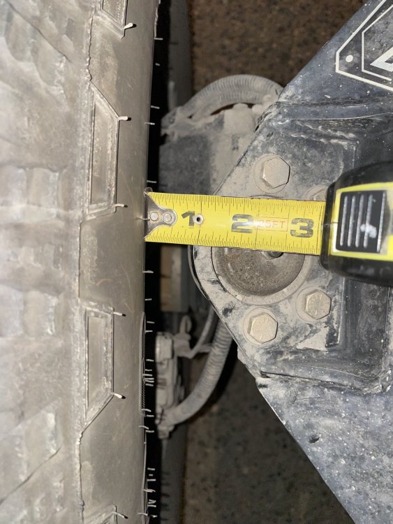

If it's not too much hassle, I'd be curious to see your clearance with that setup - this is what my truck currently looks like with factory wheels and stock 275/65R20 tires.. I'd say max 3/4" clearance before UCA is rubbing on the tire with the wheels pointed straight ahead.

I’m sorry but I think you will rub if you bump up to 12.5 width. You have 3/4” clearance now. Stock tires are 10.5” wide if I remember correctly? So adding 1” to each side will certainly make them rub.
