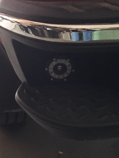

Something similar to this? I’m not blinded but it does wash the screen out and you can barley see the guide lines.
