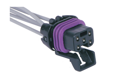

You will have to see what style plug you've got.  If its a 5 wire plug directly into the actuator, you've got the electric actuator.  Plug looks like this:
Connector 12117277 | GMPartsDirect.com
