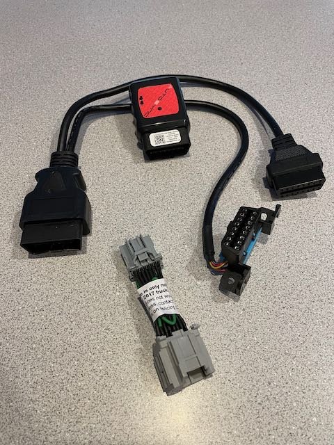

No blizzards yet this weekend so it's time to install the Autosync and get the custom BCM programming from White Automotive and Media services installed.   Also ordered a splitter cable for the ODB port as I have the AMP steps plugged into the port currently.   Pictured here is a wiring harness that I purchased by mistake from BTDieselworks... I thought that a modification was needed for 2017+ trucks, but that doesn't apply to the T1 series. The Autosync device shipped with some instructions (by mistake I'm sure) for the K trucks which doesn't apply to the T1 series - just ignore that and follow the WAMS instructions.
