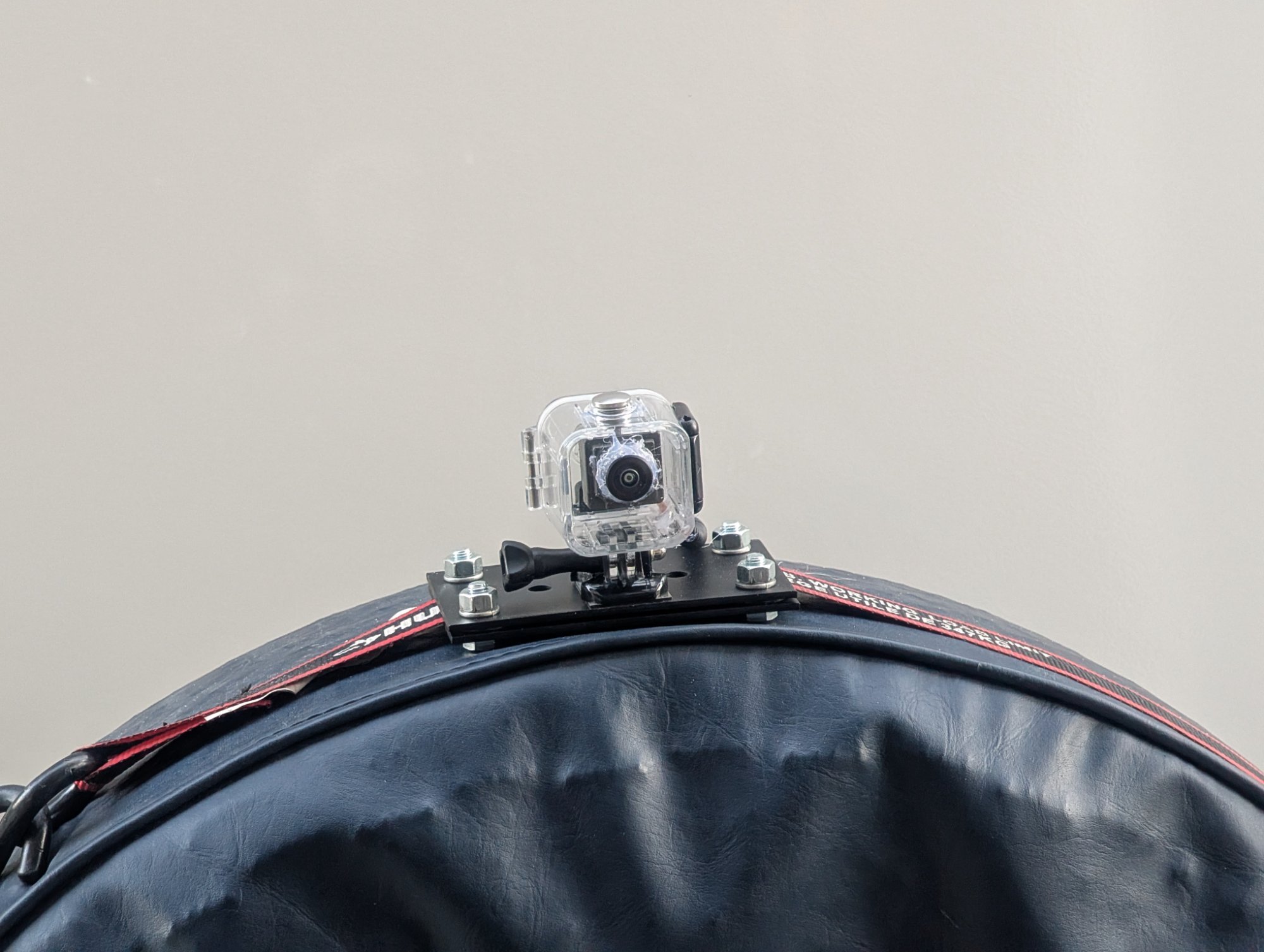

Also a pretty solid housing for 20 bucks was a Go Pro Hero Session Underwater housing. But of Dremmel and sealing work and you got a waterproof housing. Mine looks pretty rough but it works.
