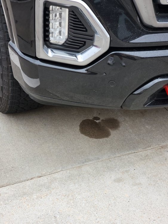

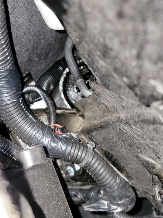

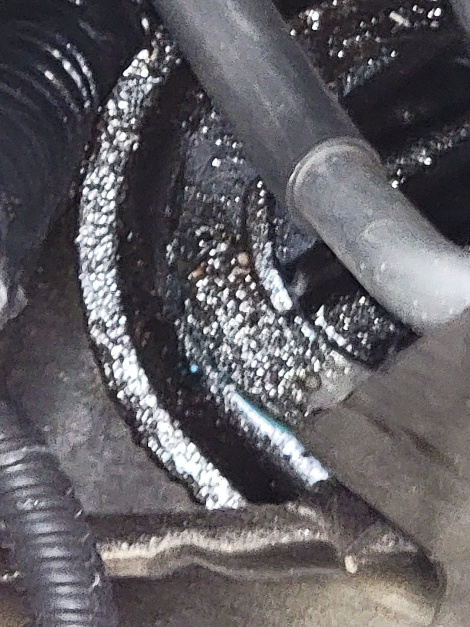

Noticed for a few days now what looks like moisture by my passenger side front wheel on the concrete.  Elected to change parking spots and of course it followed.  Make an appointment this week to take it in.
Almost looks like coolant. But I guess its the trans cooler? Keep us updated after repair.
Will do...in the shop now.
Final answer is GM part# 84240288 which is an adapter that goes on the bottom of the cooler.  #4 on this picture.
