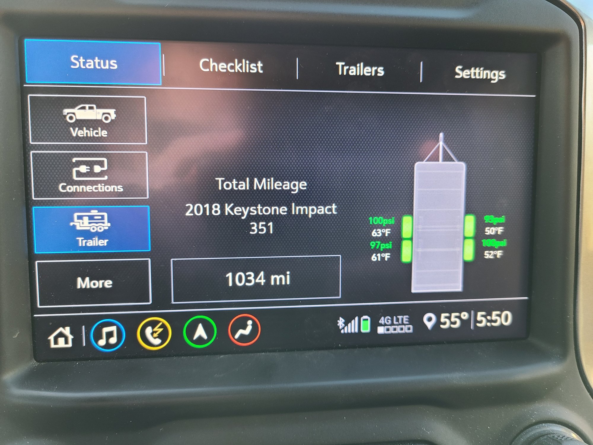

@NCCaptainMorgan, I can't speak to if your truck would come with the sensors or not...but I was able to purchase the sensors off of eBay for my 5th wheel travel trailer. Got the sensors added to the existing wheels at Sam's Club last week. Came home from Sam's Club and setup the sensors from the truck in dash screen. It basically had me release air from each tire (front driver's side, rear driver's side, rear passenger side, front passenger side) and I was all set!
Here is the eBay link to the ones that I purchased: https://www.ebay.com/p/25034266056?iid=254823853923
I believe I paid $85 for 4 sensors.

If you get the sensors, it should work --   U1D is standard on 2021 HD AT4 (and also on SLT and Denali; it can be ordered on SLE, but not on base Sierra)
PTT is the order code for the 4 sensors
The trailering app (U1D) can be ordered without adding the trailer sensors
PTT         Trailer Tire Pressure Monitor Sensors, includes set of 4 sensors. Sensor functionality requires (U1D) In-vehicle Trailering App to be ordered with the vehicle and installed by the factory. Sensors will be shipped loose with the truck and will need to be installed on trailer by customer. System is capable of monitoring up to 6 wheels. Additional or replacement sensors are available through GM Accessories
U1D    In-vehicle Trailering App, System, includes checklist, trailer maintenance reminders, trailer security alerts, trailer mileage, tow/haul reminder, trailer electrical diagnostics and Trailer Tire Pressure Monitor System module
FWIW, the system can handle up to 6 sensors per trailer and can store sensor info for multiple trailers.
Trailer sensors also transmit temperature information.
