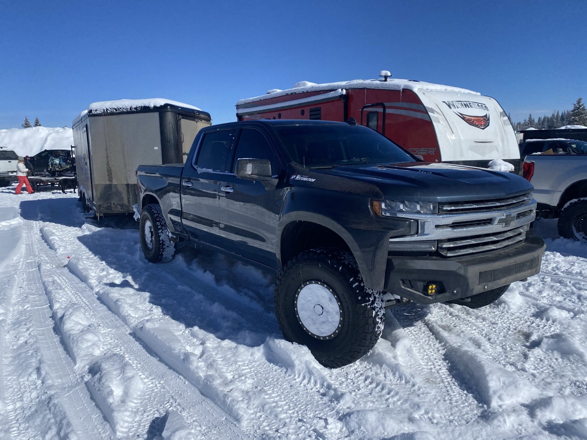

I tow a 3400# enclosed sled trailer with up to 3 sleds and gear so closer to 7000#, on 37's with no swaybar on a Bajakits 4wd long travel kit. I have deavers in the rear but airbags on daystar pads. Runs great. Little under geared but the 6.2 tugs it all pretty good and trans temps stay right around 150-170.
There is some spindle modification required (grinding) to clear the LCA on this kit. I bought the swaybar links thinking I'd install them to tow in the winter but have not even considered putting them on. I would recommend going with the dirt king kit over the Baja Kits for fit, finish, and features.

I went with 0+ offset wheels and the KO2's are technically 36" but when I had stock fenders the tires definitely smashed them on full compression. The fiberwerx fenders clear great but don't do much for mud and road spray. I wish someone would come out with 6.5' bedsides. Tires still hit the factory fender liners as I re-used them and added HDPHE extensions to seal up the gap on the wider fender.
Truck sways more than stock for sure but it's never uncomfortable or unnerving. No sway bar upfront might just be my favorite mod after the kings.
