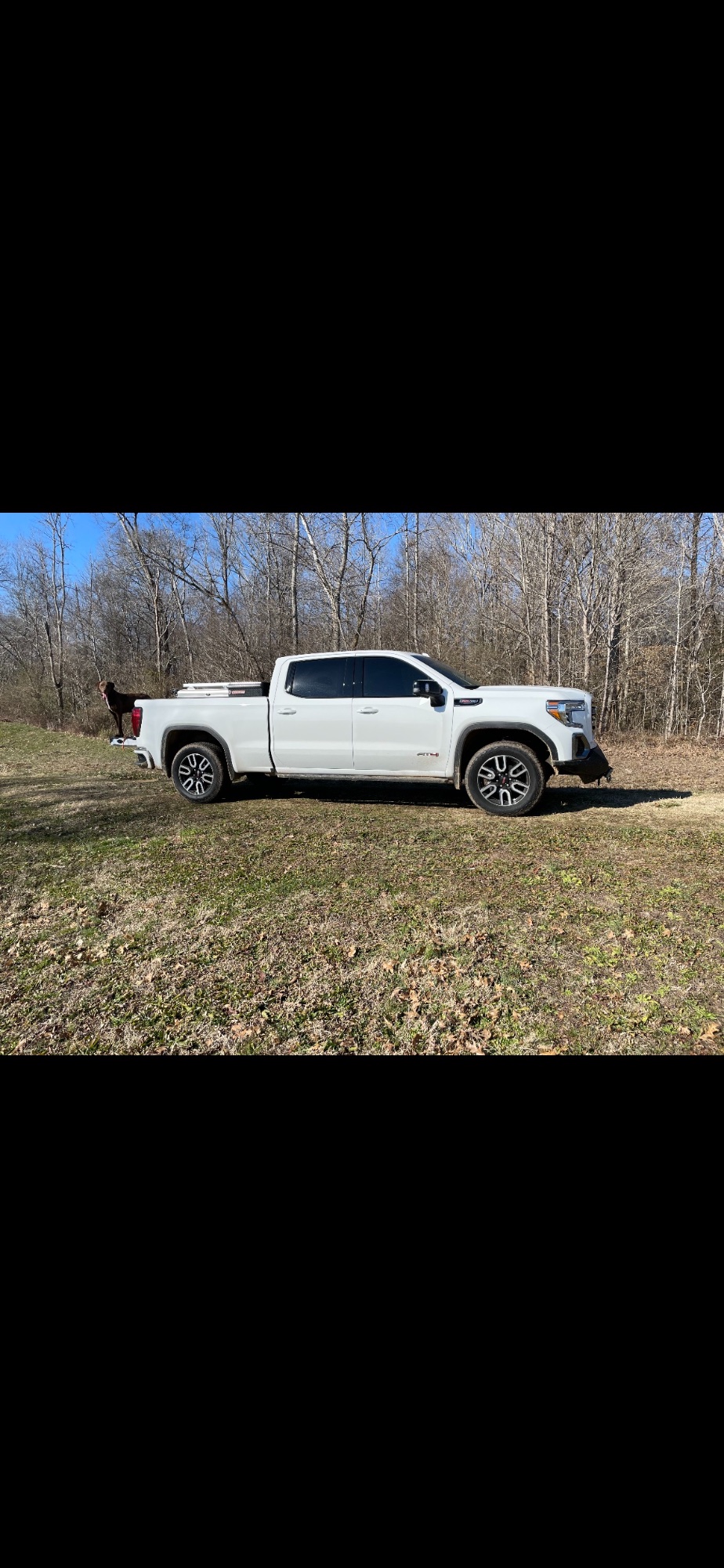

This best part is there are no trucks to replace my At4
it’s a standard bed which apparently over the last 7 years is frowned upon in a half ton
my truck is very specifically setup for what I do everyday
Since this latest generation I’ve had new standard bed z71 or x31
2015
130,000 miles
transmission replaced at 108,000 just out of warranty
2018
Z71
60,000 miles
no issues
2020
x31
32,000 miles no issues
and now this gem 2021 6.2
all others were 5.3
