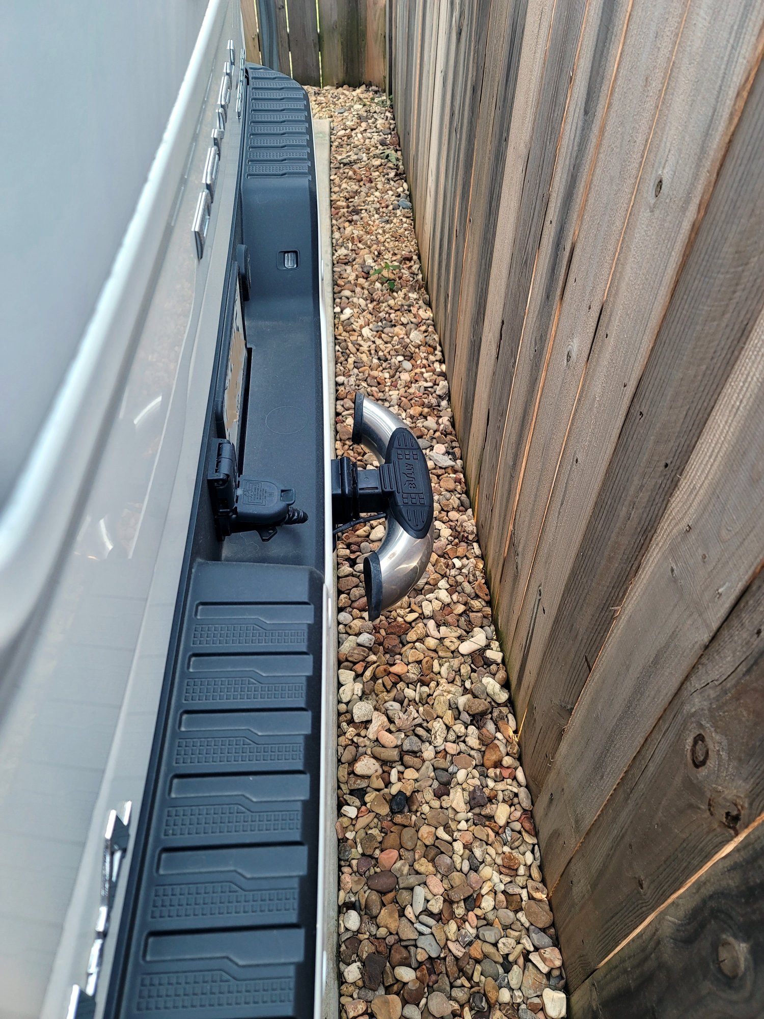

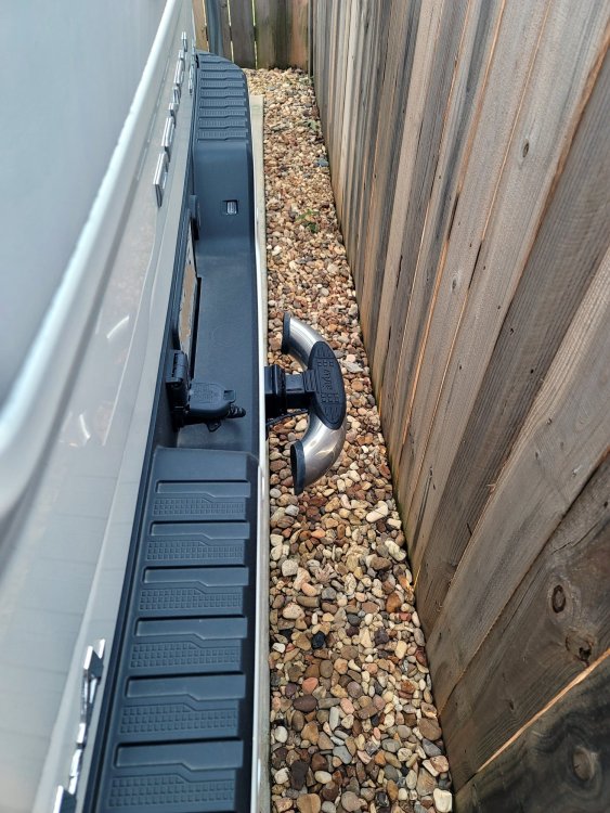

Install one of these Bully brake light hitch steps (CR-600L).  I was pleasantly surprised that the side cameras started displaying (when the turn signals are turned on) when I installed this a few months ago.  I've never towed a trailer, so I had no idea.
The seven way trailer connection has to detect that something is pulled in with similar resistance values of a trailer wiring system.
#iworkforGM
You'll need a 7 way to 4 way trailer wiring adapter in order to plug in the Bully hitch step.  GM moved the 4 way plug to the inside of the bed.
